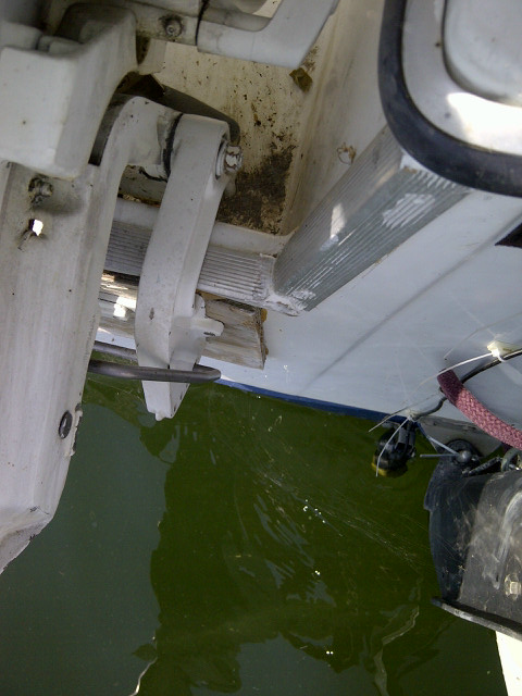

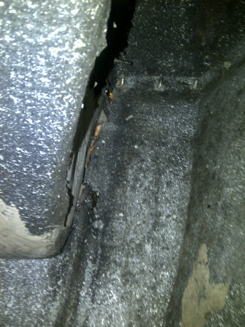

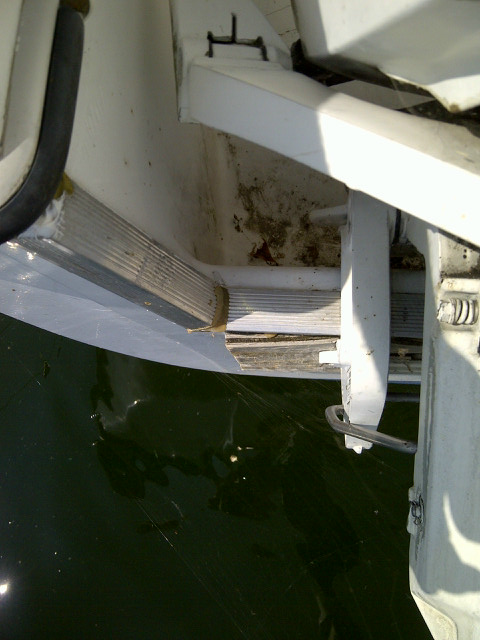

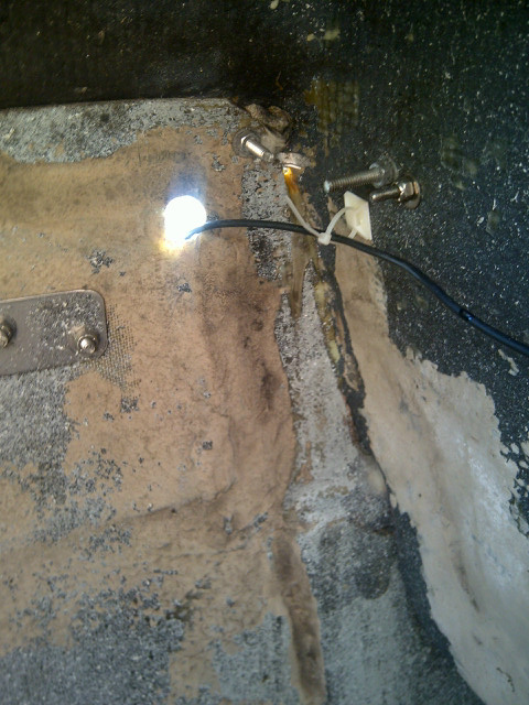

You will want to check in the laz to see if there are any cracks around the inside at the back of the motor well. I can climb right inside of mine. Here are some pictures of mine. Note: The trim is not original and I still think there is something up with my boat perhaps being taken apart. (the motor well area would have to be cut along the transom. I think mine was...)
Pictures are first two each side of the motor from behind the boat. (Not a lot of room on each side.)
Next two are inside the laz Starboard then Port sides of motor well.
If anyone else has bondo back there please let me know... I'm pretty sure it didn't leave the factory that way.
It is hard to tell from the pic but it kind of looks like someone ran a cable for a transponder through a hole in your transom. If that is the case it probably is not a big deal. Or maybe you had some cracks that were leaking and they bondo patched it?
Yep. Me. Well I just made the existing hole bigger. I plan a small cover to be fitted over the hole.
The bondo is on the inside and painted over with Flex Rock paint or something similar. If you look close you can see the bolt length is bigger. And there is some brown glue stuff around the motor well at the back. I'm going to knock the stair nose off and see what is underneath.
