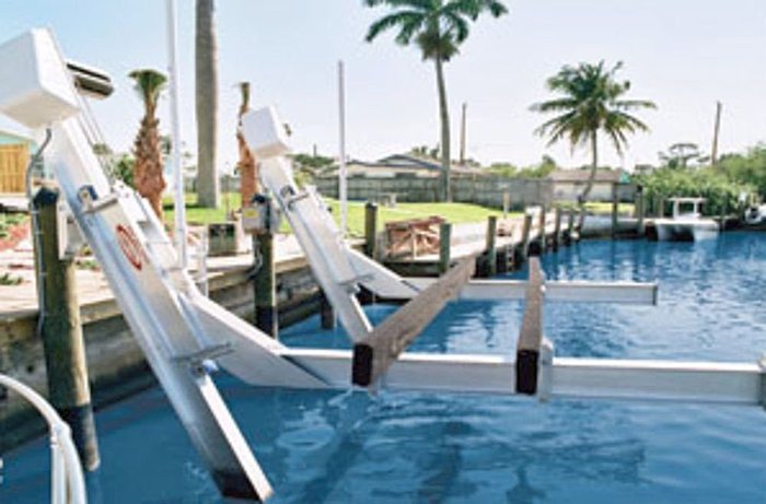

Photo of the lift with our Byte on it.
Here is a picture of what is suppose to be a ....
.... a Mac 25 trailer. I'd make some bunks like those on the trailer and bracket them to the tops of the bunks on the lift. Then add a diagonal brace from them down to the bottom cross members on the lift to put them at the angle you needed and to further locate them.
Make some "U" shaped brackets out of say 1/4 X 3 inch wide aluminum strap (online metals if you can't find it locally). Bolt the "U"'s to the bottom of the new bunks and sides of the lift bunks. Locate them a little off center on the new bunks. Put the boat on the lift (it is rated for the new weight?).
Lift the boat and the bunks should bend the "U" 's enough that the bunks will angle to the bottom of the boat.
Next I would add a diagonal on each side from the new bunk down to the lift cross-members. They would just help to locate things and give some side to side support and help the new bunks stay at the proper angle. You could put in mounting bolts through the new bunks before putting the boat on.
Now please realize that I'm not there to decide if the above is the best or safest way to go. You are going to have to decide that. Please be careful and constantly assess the situation,
Sum
