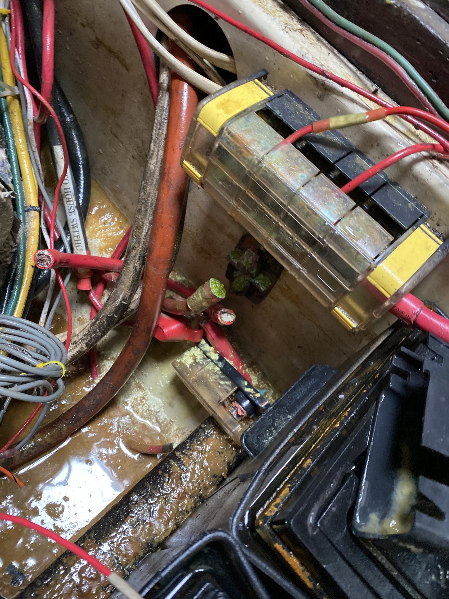

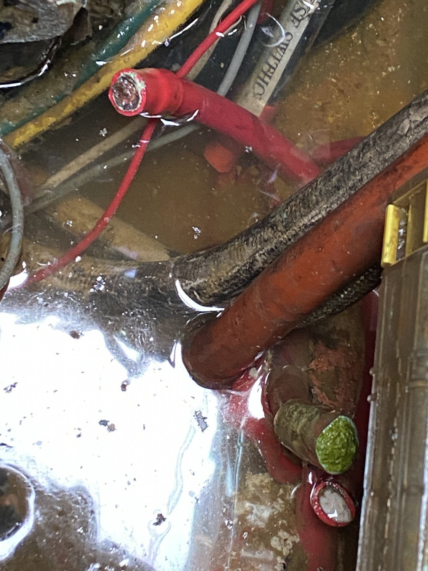

I had to redo my cables and fuses after the inundation of water in the boat occurred last August. The water reached the wiring on the engine. The fuses blew. When the batteries went under there must have been all sorts of mayhem.
I rebuilt with the same 300 amp MRBF fuses on the batteries to protect the wires running to the engine starter and the ACR for the starter battery (the ACR and starter battery were saved being located above the level of the inundation).
I have a 47HP engine. When using a 150 fuse on the starter, the fuse would blow every second or third start. After 2 failures, I upped to MaineSail’s recommended 300 amp fuse and no further problems. I noted that the original configuration when I purchased the boat did not have a fuse between the batteries and the starter motor. That was old school thinking.

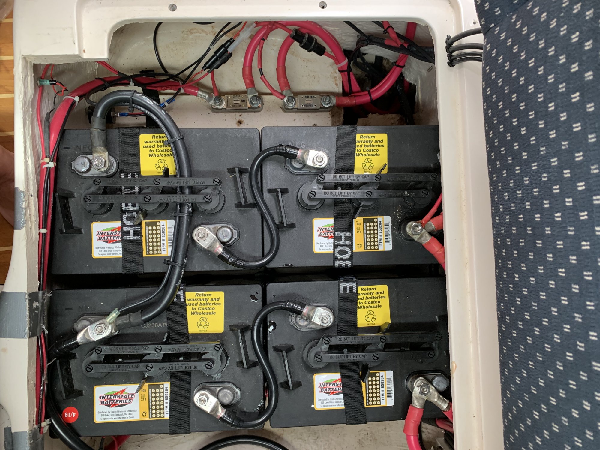

Clyde, I seem to remember the ANL fuses being 150 amp rating. One of them blew when the stater motor shorted one time, and I replaced it with the same rating. I never had a problem with a fuse blowing while starting the engine, etc. I figured if the 150 amp fuse is good enough for the factory, it's good enough for me.
Tom thank you. Have had boat for eleven years and fuse size worked for me. My boat has electric windless
and never had fuse failure during use. Think that must be original factory fuse size. This is the information
I was looking for. Thanks again.

I looked at the owner's manual and the DC circuit schematic doesn't even show the fuses. No wonder the factory couldn't help you. Like you said, though, I had my boat for 17 years, and the stock fuses seemed fine. I wish I still had my boat so that I could double check my memory.
I found this pic in my photo archives. Looks like my ANL fuses are actually 130A, so the 150's should b fine.
View attachment 223757 View attachment 223758
Great picture nice clean looking installation. Four batteries easier
to handle. Easy to read fuse number. Thank you for sending.
