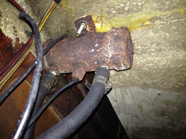

Exhaust elbows do not exist on M25 engines on these and other Catalinas. They are different than Yanmars. The exhaust system consists of an exhaust RISER which is a 1 1/2" or 1 5/8" insulated pipe that connects to the rear of the engine manifold to carry the hot exhaust gas to the water lift muffler. The now hot exhaust raw water from the HX is introduced into this pipe close to the muffler, and then they are pumped overboard.
