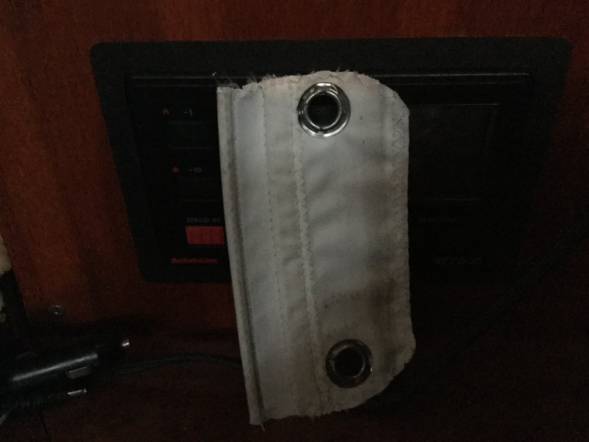

Now that the coffee is kicking in I’m thinking this boat was built in RI and used mostly local suppliers for parts. I made this to clean the groove so I can send them this for a good match. Thanks for all the help everyone.

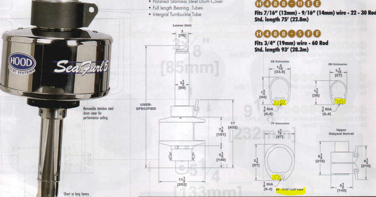

This is the picture that you posted
The answer to you question is probably Best summed up by DrJudy: get a couple of short pieces of tape and make sure.
