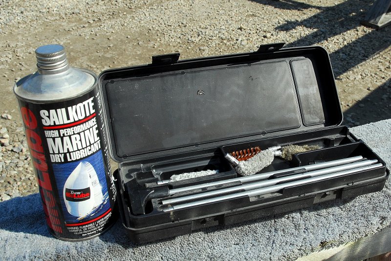

Hi All,
I wanted to pass on a trick I tried and one that works very well.
Lube the mast track with McLube SailKote and a shot gun cleaning kit. The difference will be AMAZING. I also did a t-shaped spar track, of the guy next to me, and the gun cleaner conformed to that slot perfectly too..
