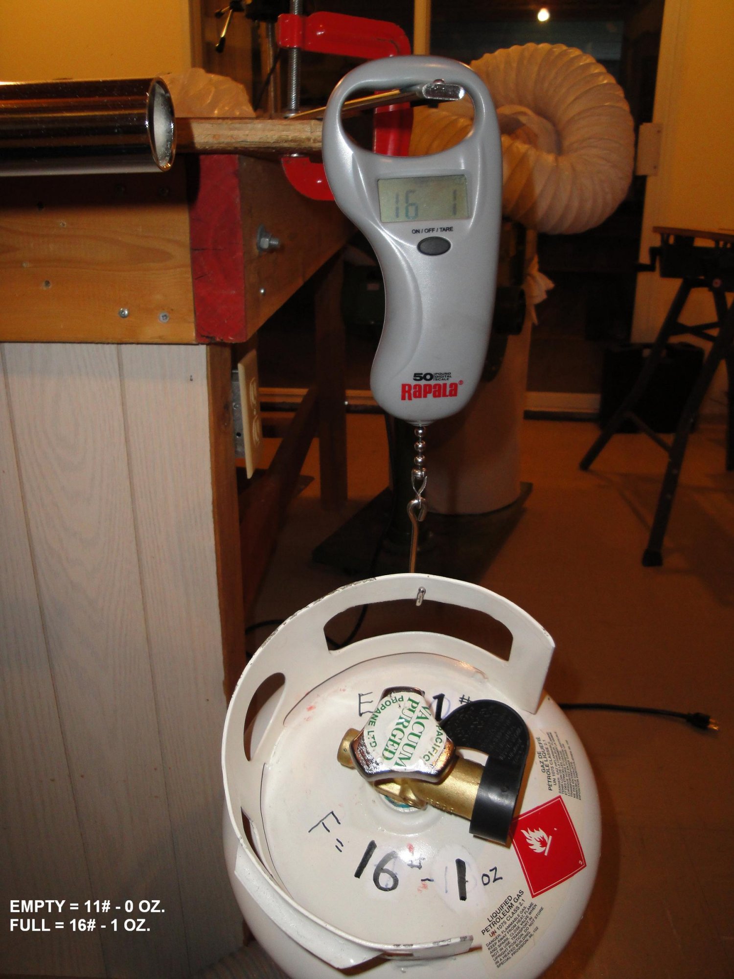

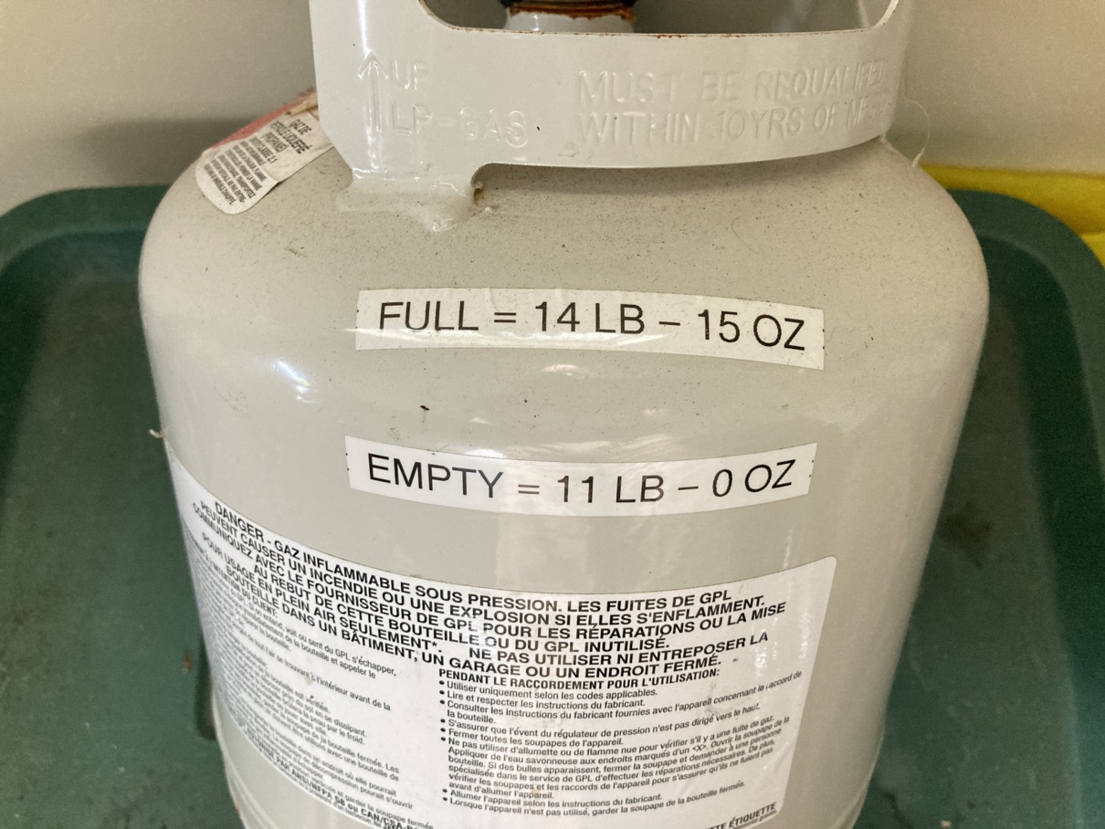

Ralph is right on, that's exactly what I do. I weigh a new or empty tank, and fill it, then weigh it again, and write these on the tank with a permanent marker. I use a digital scale I got on Amazon for $10.
But, you now would have to know the rate at which you use gas! I found I get more than one season per 10 lb. tank, making coffee every day I'm aboard, most weekends and a couple of weeks in the summer, and also cooking once a day or so during those two weeks.

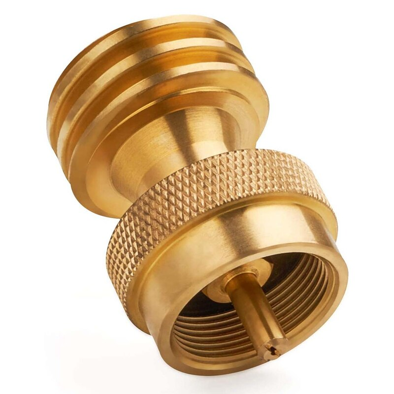

I also have an adaptor for the 1# disposable bottles (that was all the PO used).

We live on the boat 6 months each year and get 65 to 75 days out of 10 lbs tank ( possibly slightly overfilled - no scales where we fill ). And yes you can tell by pressure when you’re close to empty. around 50 psi will give you 2-3 days. Having 2 tanks lets you empty the tank completely. The adaptor for 1lb/bbq bottles will help as well.
