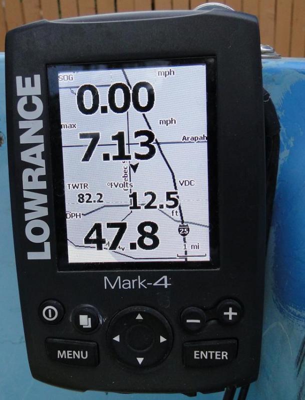

I have a Lowrance Mark 4 that I use in a 15 foot "experiment" boat that likes to plane. Other than the problem Ill talk about below, I like this instrument as I can set up the display how I want and it doesnt use much power (about 2.2 watts as shown). In the picture, I have from top to bottom Speed, Peak Speed, water temp + battery voltage, depth. Overall just about perfect for this electric trolling motor powered sailboat - since I even can see the battery voltage.

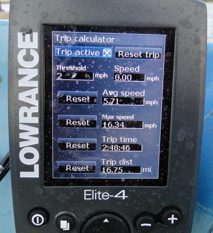

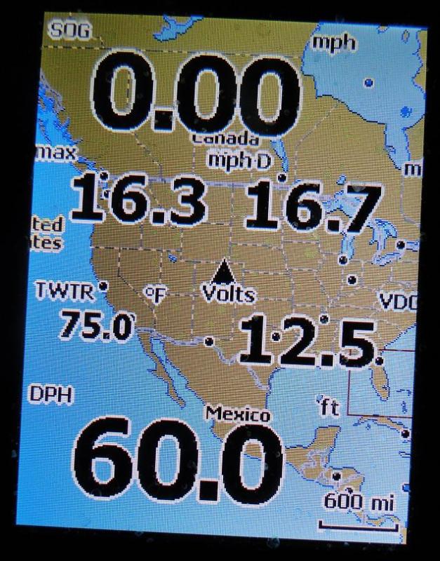

follow up.. I picked up a brand new Lowrance Elite 4 and installed it today and of course had to also take the boat out within hours. Absolutely wonderful day sailing and the Elite 4 overall worked well but I still got a false peak spead reading of 16.34 mph. You can see in the pictures that the instrument has about as clear view of sky as possible.. so I give up on the peak speed, I think the software for this needs a little work still. Still like the instrumement for all the other things it does - speed overal works well. Before I got the bad readiing, the peak speed was about 7.8 mph which I believe.
