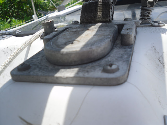

ok what is the manufacturer of the mast and is there a mast raise system with it. If not, go back to the seller to see if there ever was one.
This is the base of the mast and the plate it sits on. As far as finding the previous owner, he is absent. I bought this boat as an abandoned with a storage lien to get the title. The previous owner was an elderly man we think has passed away.
