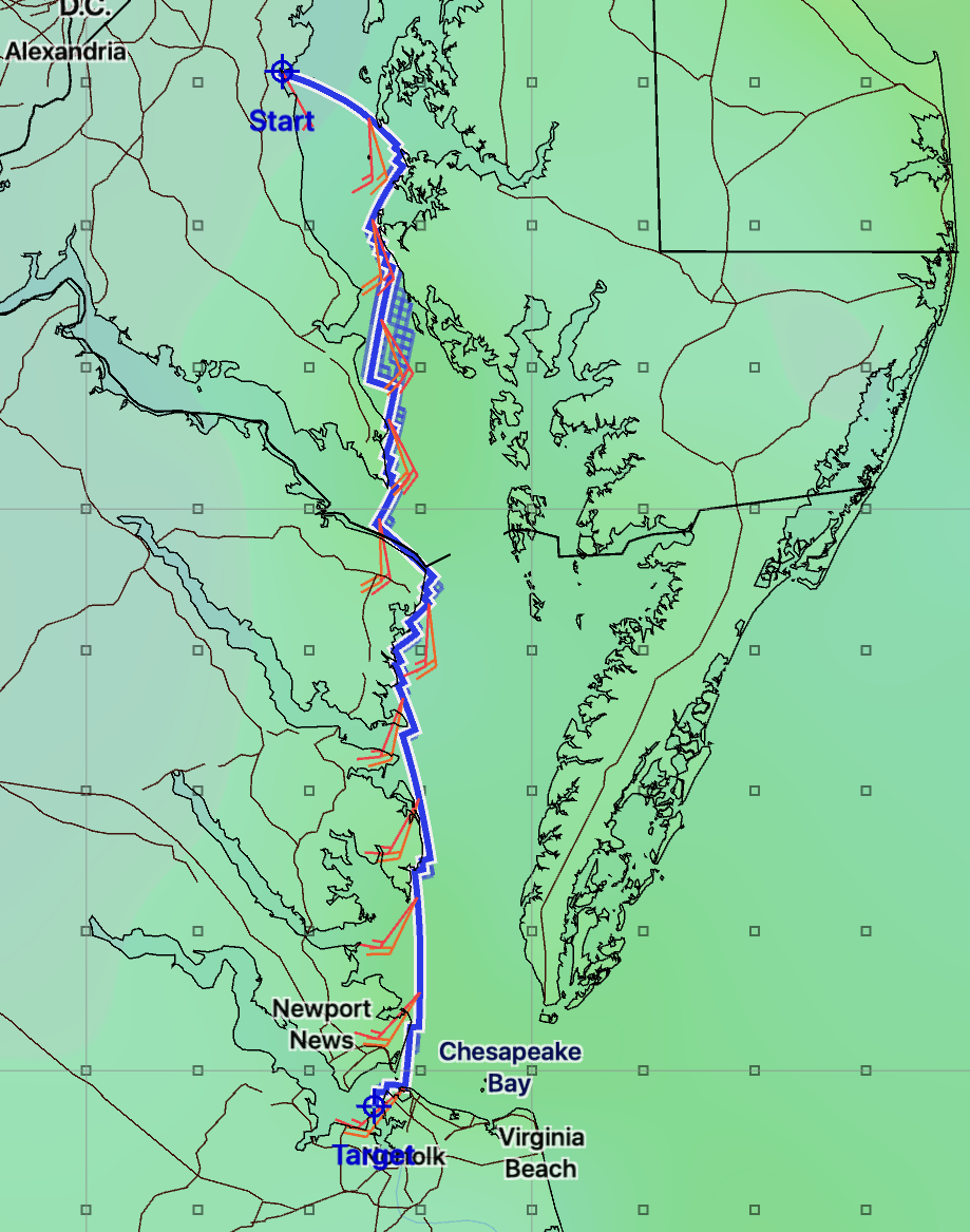

It is approximately 140nm from Herrington on the Bay YC to Norfolk, VA. Based on today's weather conditions, it would take you 28 hours on the water and about 49 tacks to travel to Norfolk on a boat that cruises at 6 knots. If the weather were more favorable, you might catch a westerly and be able to reach most of the way. This might save a couple of hours on the trip. If you were to travel under power the whole distance, I would plan for 5knots SOG. As you move south, you may find you can not hug the western shoreline, as the rivers have a nasty habit of depositing their silt as they open on the bay. I have been out to the main channel off Rappahannock Spit and Wolf Trap to avoid shoaling. It adds a couple of miles to the cruise but avoids the shallow silted waters.

Here is the data developed. I used my 35ft boat that has a cruising speed of 6 knots in the rough estimate model.
Weather Routing solution details created at: Sun Apr 12, 2026 7:46am PDT
Vessel name: Default Vessel
Solution name: wind
Sailing polar: CAL 35 @ 100%, night scale: 80%
Wind file: GFS.20260412.06.grb2 @ 100%
Sailing angle limits: upwind: 35° true, downwind: 165° true
Avoid wind speeds greater than: 30.0 kn apparent
Avoid wind speeds less than: no limit set.
The vessel is not allowed to heave to.
Tack/Jibe penalty: none.
Land clearance distance: 0.0 nm
Constraint sequence:
38°46.2'N, 76°33.6'W. Start point.
36°56.2'N, 76°21.3'W. Target point.
Route start date: Sun Apr 12, 2026 7:46am PDT
Arrival date: Mon Apr 13, 2026 11:35am PDT
Local arrival time: 1 hr 20 min after noon
Duration: 1 day 3.8 hrs
Distance traveled: 139.9 nm
Motoring time: none
Vessel speed: max: 6.1 kn, min: 3.1 kn, average: 5.0 kn
True wind: max: 18.9 kn, min: 6.5 kn
Apparent wind: max: 23.5 kn, min: 6.6 kn
True wind angles: 0° 45° 67° 90° 112° 135° 157° 180°
% time: 93% 7% 0% 0% 0% 0% 0%
min true wind: 6.6 6.5
max true wind: 18.9 16.7
min app wind: 9.2 9.4
max app wind: 23.5 20.2
Wind speeds: 0 8 20 25 30 35 40 kn
% time true wind: 2% 98% 0% 0% 0% 0% 0%
% time app wind: 0% 53% 47% 0% 0% 0% 0%
