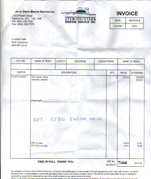

You cannot tell the condition of a motor mount via a visual inspection. It could be shot and it would likely look good. You could try to rock the engine back and forth by hand to see if there is a broken one (not likely in your case) and the easiest way to identify weak ones is when the vibrations become excessive. Like I said at 20 years they could be starting to weaken but by thirty I would go ahead and replace them. Replacing motor mounts entails loosening and lifting the engine and then the delicate job of re-aligning it. This work plus the cost of new mounts makes it a big repair to be done when it becomes necessary.

So that was $300 for a single engine mount! Well--all of this convinces me to take the "watch and wait" approach to the problem. The vibration itself is minor, goes away by the time I leave the marina, and then I put up the sails. I should be worrying more about my sailing skills--as woeful as they are--and less about a minor vibration. My mechanic does want to check the coupler, which I'm going to go ahead and have him do--if that's OK, I'll put the issue to rest.
