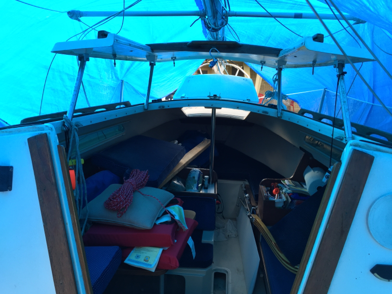

Are you planning on doing any work under that cover while dry sailing? Would the cover give you enough room to work if supported over he cockpit? I only ask because I threw a tarp over the mast as a cheap, easy cover, secured by bungies to the trailer. I left the bow and stern open to facilitate a breezeway as to not suffocate while working in the cabin. It seems to work ok for now. I lifted the mast crutch up two notches and threw the tarp on it. It's helped when sanding the wood on rainy days.
I'm always looking for new/better ideas than what I dream up by myself.

I got the cover with the intent of using it when towing the trailer, and when it's parked at home.
I had thought that if I needed to do some work on the boat I could do like you did with a tarp over the mast with the pop top up.
The cover is advertised as fitting 22ft boats with an 8ft beam.
The C22 is just under that in both measurements.
As you can see from the photos, the cover appears bigger than that when sitting on the deck under the mast.
With the mast laying just above the closed hatch and the spreaders disconnected, the cover should JUST fit.
I'm thinking it might be somewhat usable for working on the boat, if I loosen the straps and have the whole cover go up. Kinda like a poptop cover... hehe. Just sitting over the mast and out to the tops of the stanchions with some PVC pipe form stanchion to stanchion.
The big issue will likely be light penetration. Plastic tarps let light through, but this polyester fabric with rubber-like coating probably won't let much in at all.
Once I get the boat functional, I'll be experimenting with the cover and post the results
