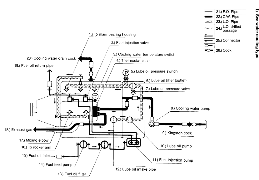

1. The next "fix" I guess will be changing the oil pump. The troubleshooting guide in the Yanmar manual states "see your Yanmar dealer" for oil pressure issues, and the diagrams in the manual are somewhat cryptic as to where it is located.
HAS ANYONE EVER CHANGED THEIR OWN OIL PUMP, AND WHERE IS IT LOCATED ?

The oil pressure switches do go bad so an option would be to install a pressure gauge either temporarily, or permanently .. A bad switch would be the most common cause of the alarm. The Yanmar spec for the switch indicates that it turns "ON" at 1.4 to 4.3 PSI. this is the switch:
http://shop.toadmarinesupply.com/ships_store/?p=details&mfc=Yanmar&sku=124060-39452&sectionid=
A wire short can do that but usually it alarms all the time and not after a run. Another thing that can cause this is a small piece of debris in the oil pressure control valve. The valve is in the threaded piece that the filter screws onto.
The oil pump is inside the front gear case cover so replacing it is a pretty big job.. Requires removing the injection pump and crank pulley and messing with the governor..
