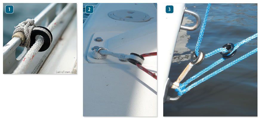

Take a look at the Practical Sailor article below.
In your drawing it appears that you have the restraint or mounting for the ring going through the middle of the ring and the load going around the ring. I believe this is incorrect. The loaded line should go through the middle of the ring, running around the circumference will increase the line's contact with the ring which will increase the friction of a loaded line.

It sounds like the conclusion of PS was exactly in alignment with my preliminary hypothesis.
"Conclusions
While not a replacement for ball bearing blocks, rings are probably the best choice for something on every boat. Next time you are rigging a small cascade, a rigging tweak, or something with huge loads, give low friction rings a look."
