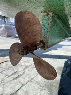

I lost the prop on my Beneteau 473. I am trying to figure out the shaft size and propeller size. Does anyone have any info on this?

Just got back from marina and dove the boat.... The shaft is straight and not damaged. That is great news!!!!! It appears the loss was due to the bolts coming off. I am pretty sure this uses a castle bolt but no cotter pin. Still researching. I used a caliper and the shaft is 30mm. I measured it on the outside and on the inside and both were 30mm. The reply from "Davidasailor26" seem to be accurate.
