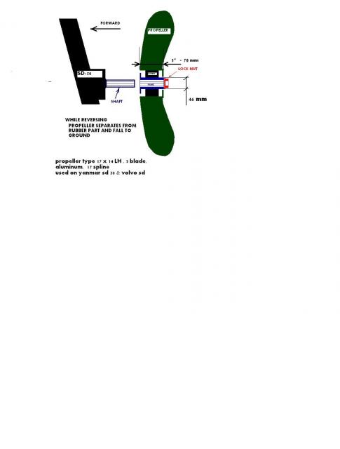

my H38 with yanmar saill drive 50 lost prop at sea while reversing
prop is 3 fixed blades 17 x 14
any explanations

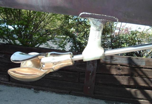

Depends upon how the prop is secured. My Flex-O-Fold does not have a locknut nor a cotter pin. The nut is recessed and locked in place with set screws from the sides of the hub. If the key were to shear the prop could unscrew the nut with enough hard reverses.
It has and it did, in the Erie Canal. I replaced the bronze key with a stainless key. I have a shaft-saver and do not need a "shear key". I got the prop back in November when they drain the canal for maintenance.

So you are no longer stapled together Nick? Hope you don't come apart. At least wait until the glue dries before you go in the water. Do you have a suit? I pay a diver monthly. Not sure I would want to swim in the marina. He always reports how bad the shaft and prop are. I would think there is enough copper in that alloy that we would not be bothered so much. Your story makes me hope the diver is doing a good job. As you know one of the things about the Flex-O-Fold is that a zinc covers the end of the hub. One reason for the recessed nut. In this picture the zinc was not yet installed.

Nice jpg- but wouldn't it be beter to put a second(locking) nut on the end and put your 2 zincs mounted on the shaft forward of the skegg- you have the space. ??????

answer: fixed prop should use yanmar large cone nut and not the small one
Hello all
in fixed prop , the prop blades are mounted on rubber bushing
they may slide off it.
only the blades separated from the central part / spline
the reasone is that the fixed prop was fixed to place by a small diameter nut (supplied by yanmar for foldings prop ) which is wrong
fixed props should be fixed by large diameter cone nut which keeps in place central spline part and also rubber part with blades
i have used the small nut since yanmar manual states that the cone nut is optional which is not clear and misslead
