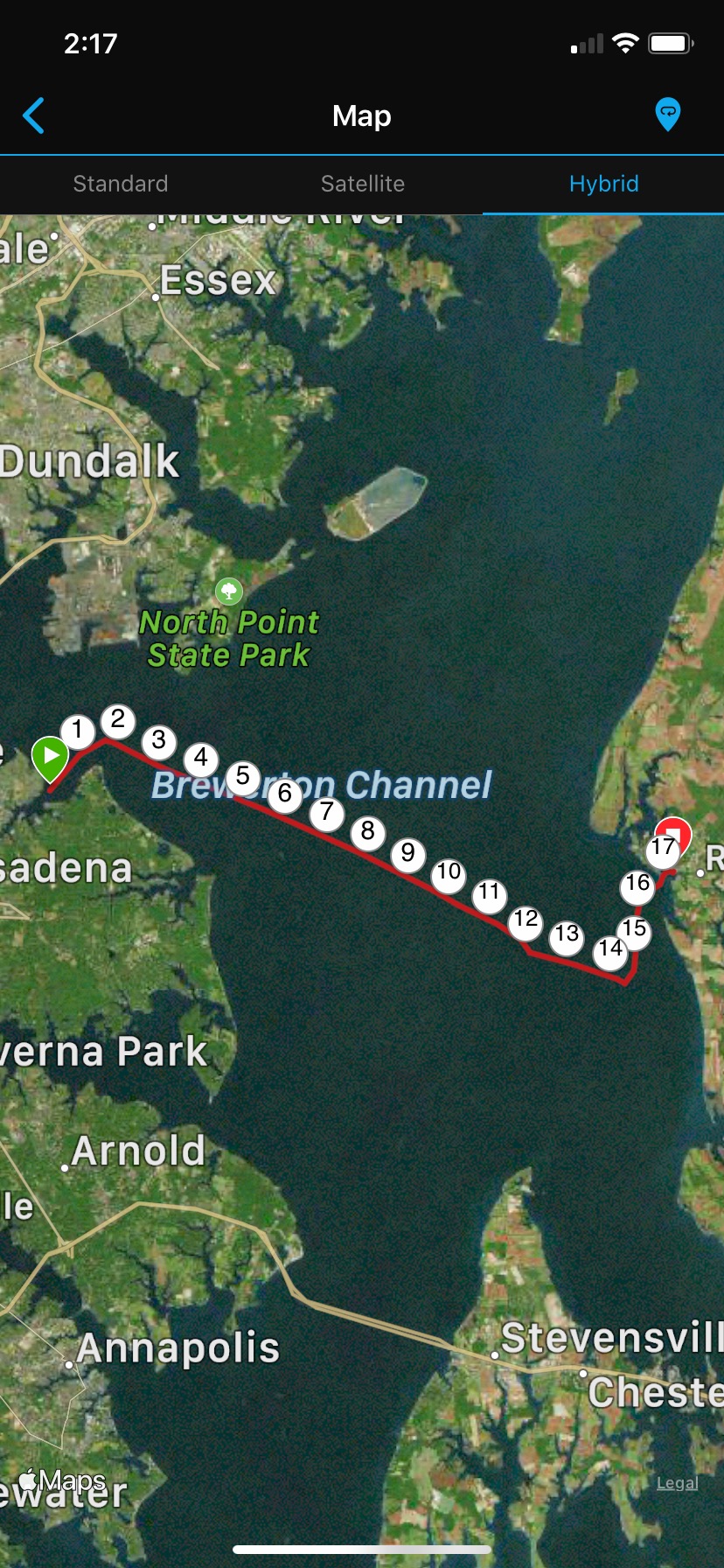

I did use Apple Maps (presumably your IOS maps) on a trip across the bay to Rock Hall a couple of weeks ago, just to get some GPS coordinates to try to reconcile some things I was seeing with the paper chart. Actually, I steered for ~12 miles to a compass heading I got from the paper chart, aiming for a small Green Can #3 which marks the southern end of Swan Point bar, an obstacle on the way to Rock Hall. Sort of an intellectual exercise, as I could just have easily buoy hopped most of the way along a channel a bit farther north, but it was fun to do the long (to me) reach just by compass heading. Made me feel sort of ... old school nautical:
But the way I ended up getting a track for later was with my Garmin GPS running watch. I turned it on as you would for a run, and when you get back to the internet with your phone, it overlays the track on a map. Kind of fun to have the picture, later. This was before I loaded iSailor on my phone.

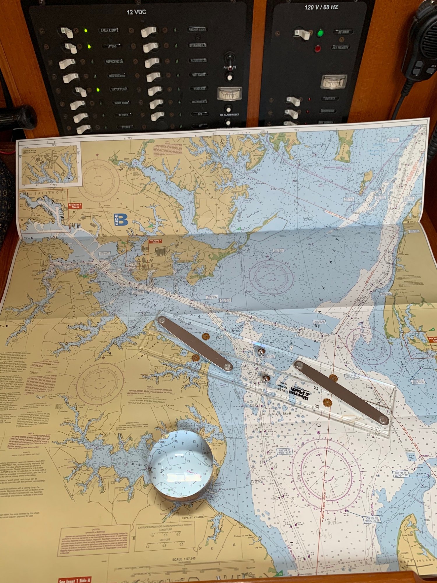

That a boy. I like it.
Probably the first time I've used the chart table for its intended purpose... I've used the paper charts many times, just not the chart table, parallel rule, etc. My Dad (now passed away: Captain Sweet, USN) would no doubt be proud, as he's the one who bought all the traditional chart instruments. Not to mention the boat!
