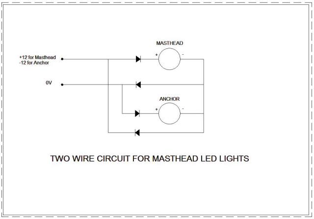

Three Options
Paul,
herewith three suggestions:-
1) Use mast as common ground return - not very satisfactory for several reasons.
2) Mount small changeover relay at the masthead - again crude, old fashioned engineering.
3) Make small sealed box containing the attached circuit and mount at masthead.
You will probably need a junction box anyway.
LED lights run off a regulator so should not suffer reduction of output with two diodes in series. This is easy to check at home before making the box.
Also, last week, friends complained of one competitor in an overnight race that he disappeared when on port tack.
They looked into it and the Lopolight was mounted flat on the masthead plate but offset. The fitting cast a shadow when the boat heeled.
The junction box suggested here could be used to raise the light to overcome shielding by the masthead plate.
