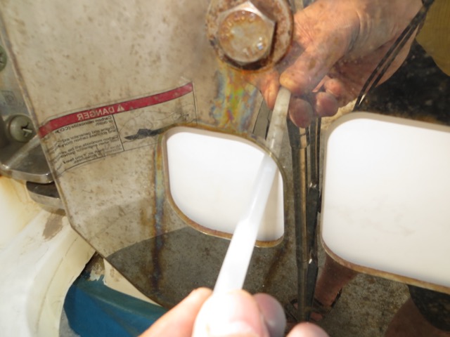

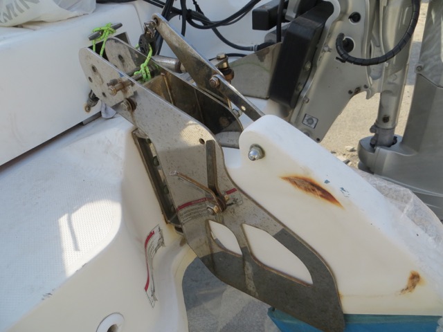

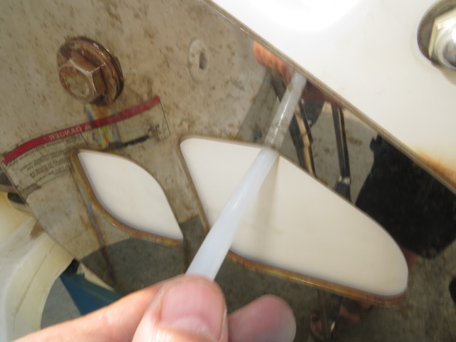

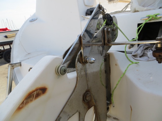

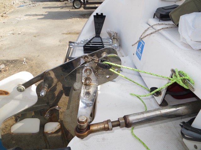

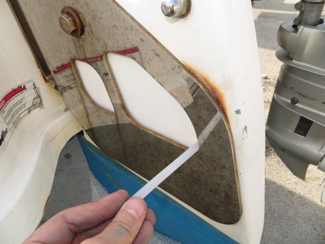

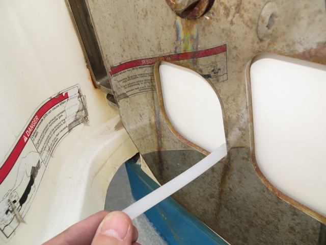

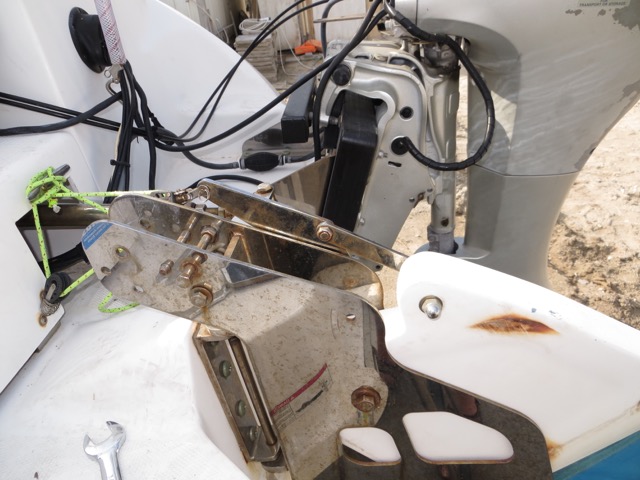

Hi Dave, had another close look today but not much to report apart from initial attachment point for raising wrong per Hunter drawings. However this does not help stopping the rudder from swinging back easily. The rudder nylon bush is worn but even so the welded nut handle does not tighten the stock onto it enough to stop the swing, having a tab washer on the bolt head might help it rotating but used a spanner to hold and still cannot tighten enough. Eddie from marlow-hunter suggested the Delron pin so have attached a couple of pictures with possible pin location, until I go to UK can't buy a proper shear pin so am toying with the idea of glue stick from another thread I came across for now. Cheers Deano

I would be cautious of drilling any holes in the rudder because of water penetration into the rudder itself which could adversely affect the core of the rudder if below the rudder line.
The metal tang or strap that is attached to the back side of the rudder head, can you drill another hole in it to shorten the distance. That should be able to raise the rudder out more. I think that is what I did to the rudders on the 25 I sold in order to get the rudder further out of the water.
As for locking the rudder down, adding two more delrin bushings or a thick style neophrene gasket in addition to the delrin should solve that problem. Let me know what you think?

Thanks Dave, funny enough a colleague said exactly same as you about water ingress when drilling a hole. The points to drill I was looking is above the water line as you can see, maybe I could think about getting some resin into the hole. I like the idea of some rubber washers glued where the plastic bush has worn which might add enough friction to hold the rudder down. I am not concerned about raising the rudder any further only making sure it stays down but will still kick up on any impact and only because its lower than the keel !!

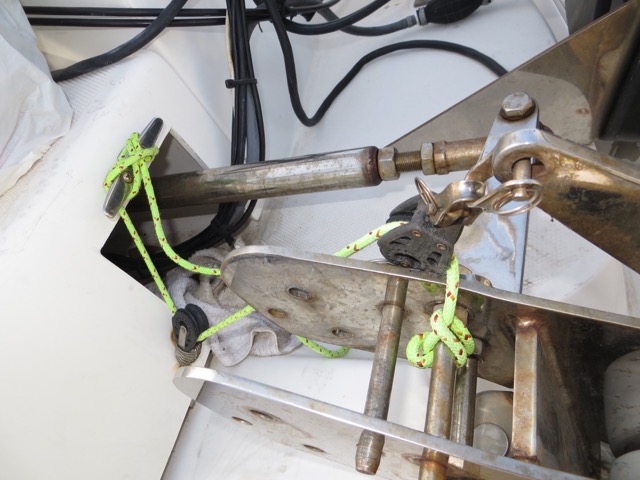

Ok, have no idea where to get Delrin Bushes from so can look into neoprene gasket idea. The other thing I found was to tightening the lifting arm mechanism at its swivel point helps which I can do once launched as I no reason to lift the rudder on the wet mooring.
