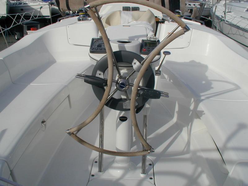

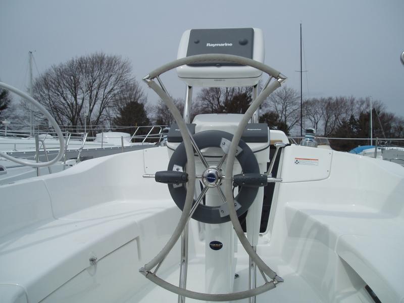

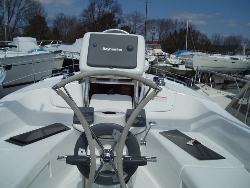

2007 Hunter 38. Anyone having issues with a loose pedestal guard? The base is snug (at the deck) with no issues. It is only the upper portion where the Chartplotter NavPod is mounted. This upper portion (in the general shape of an inverted U for reference) is fit inside of the 2 tubes at the base portion (at the cockpit table height) and held in place with single set screws on each tube. The upper portion rocks forward / aft with approx. 1/4" play.
It would appear that some sort of reducing collar along with the set screws would be appropriate, but the tolerance of the fit of smaller tubes into the lower larger tubes is too tight for a collar - it would also require a full dismantle to install a collar. The other thought was adding another set screw above the existing set screw, but I am concerned about drilling through 2 tubes (along with the fact that its a wire chase). The last thought was to somehow dimple the tubes at the existing set screws, but I am not sure how to do this other than replacing the phillips head set screw with a similarly threaded hex head bolt and torquing down (which is concerning for me).
