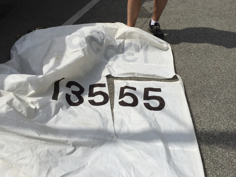

Ripped our regular mainsail in 17-23 mph sustained winds a few weeks back.

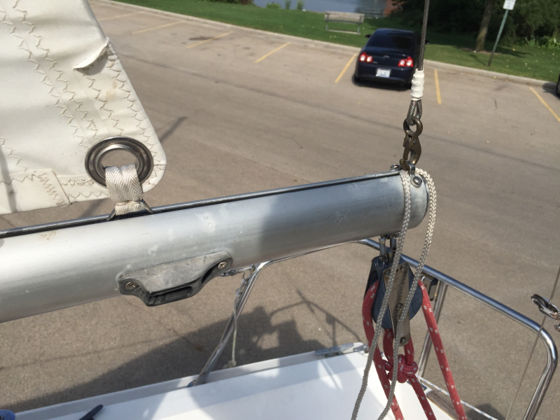

You can just see the one attachment point with its big, beefy grommet & slug. No, I didn't put on the out haul. I instead decided not to sail as we again had 17 mph winds gusting to 23. Not trying that on a new kinda sail with inexperienced friends.

While some sailmakers will still offer a slug setup, the current best-practice is to use a long double-sided velcro strap to wrap around the boom and through the clew. Very strong and allows easy adjustment, in particular if you spay some McLube under the strap.

That must be what I saw in the pic, with the strap. Would a strong puff fill the sail so much as to move the strap if it's lubed?
Still learning. Thanks for the patience. I'm rather curious now as to how she'll sail with the loose foot and better shape.

No, you want the strap to be tight. But it needs to move when the outhaul is adjusted.
