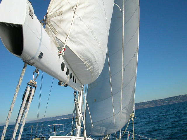

22,784
Beyond serving as a rainwater catch basin, the shelf foot can double as a place to sit or rest like a hammock. :stir:
Is this a reason to run down to the boat and attach a shelf foot to your sail?:cool:
I think not.
But you could buy an old boat, raise the mainsail and likely find yourself with this antique feature.:dancing:
