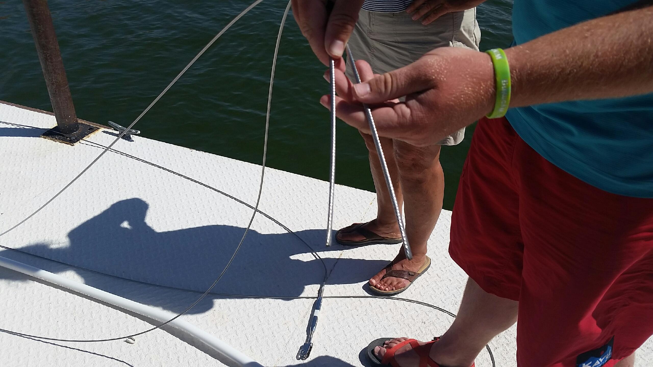

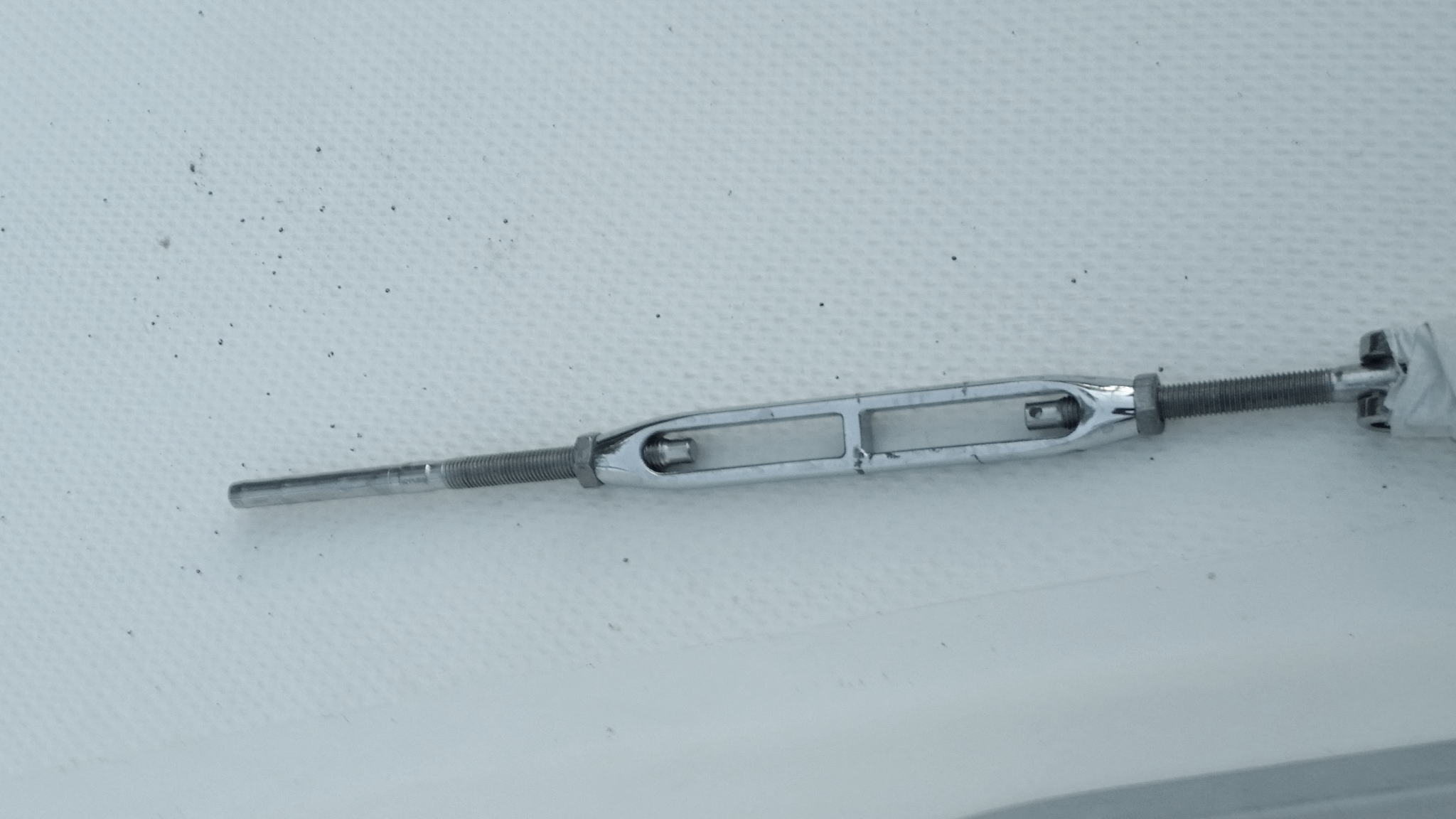

I had a mast go overboard this summer due to failure of the swage's to turnbuckles. This was new rigging I had made up by a reputable rigging company. We are still discussing the issue of the swage's they performed.
From now on I am going to paint a small white ring around the shroud where it enters the stud. This way I can see if the wire and stud are not moving away from one another.
My shrouds became loose during sailing but I attributed this due to the shrouds were new and were stretching. I have a feeling that the shrouds were pulling out all summer long as I tightened the turnbuckles more often than I would have expected.
