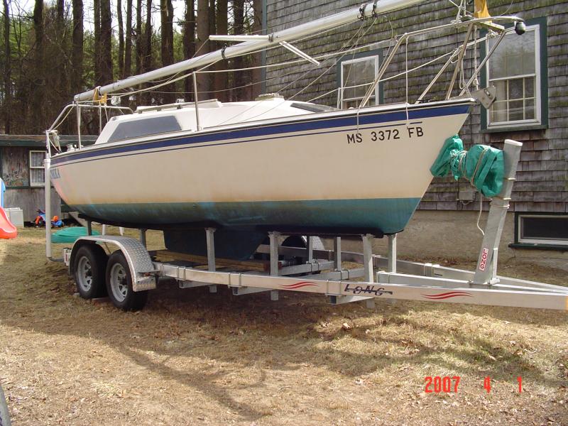

I would go to Walmsley Marine and talk to them about buying a trailer for your O'Day 25. I bought my Long Mfg Aluminum tandem trailer there. Long had gone out of business and they came back just recently.

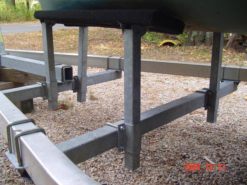

You could buy a powerboat trailer like I did and convert it over to a sailboat trailer pretty easy. Walmsley had 24" bunk extension brackets in stock when I bought my trailer and these are the best and strongest brackets I've seen on the market. I don't know if they still carry them though but they have a lot of trailer parts.

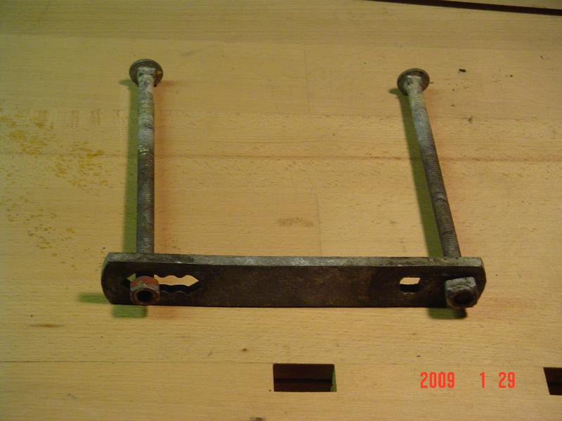

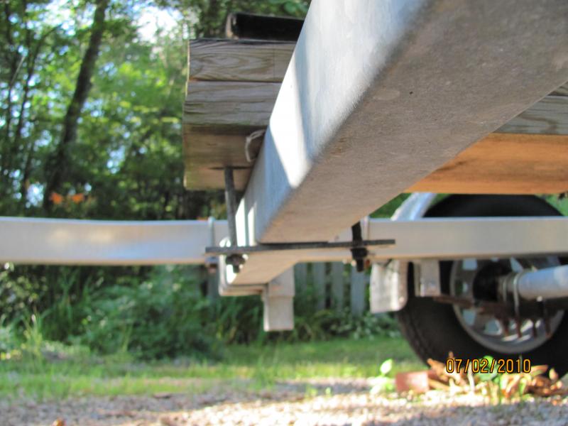

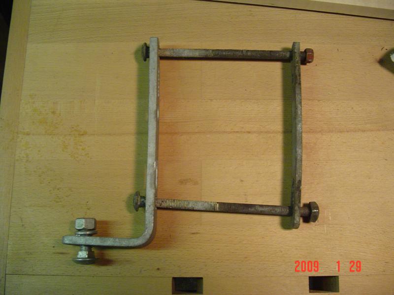

All I did was add two pressure treated planks for the keel to rest on. I sandwiched them together and used power company galvanized lightning arrestor brackets to hold them to the trailer's cross members. I countersunk the carriage bolt heads into the top plank so that the keel won't hit them. No holes were drilled in the cross members to attach these planks. The brackets can be loosened and the planks can be slid to one side or the other. This is important if you need to get at the under side of the keel.
If you buy a trailer try to get one that will not only take the weight of the boat fully found, but also a longer boat. Get a trailer that will take a 26' boat and this way you'll be able to back down the ramp into water deep enough to float her off without swamping your towing vehicle.
My boat is 22' long and the trailer is built for a 23' boat. I'm able to get my boat on and off my trailer at the club with very little effort.
Even if you don't wind up buying a trailer off this dealer, he has all the specs on your boat and can provide you with the info needed to find something suitable somewhere else with the same trailer specs that should fit your boat. Good luck with the O'Day 25. Maybe I'll see you out on the bay some day. My boat is easy to spot. I tow a small green kayak and I sail with my dog.

No. I bought those brackets from Walmsley Marine, a Long Trailer dealer in Warren RI where I bought the trailer new. My trailer originally came with 8" brackets and I needed 24" brackets and he had them in stock.
Unfortunately, Long mfg went out of business years ago and their brackets are nowhere to be found.
It's a crying shame that nobody is manufacturing these brackets. They have to be the best on the market.
All one would need is these long extension brackets, the bunks, and the keel boards and you have a sailboat trailer that can be made from any powerboat trailer.
