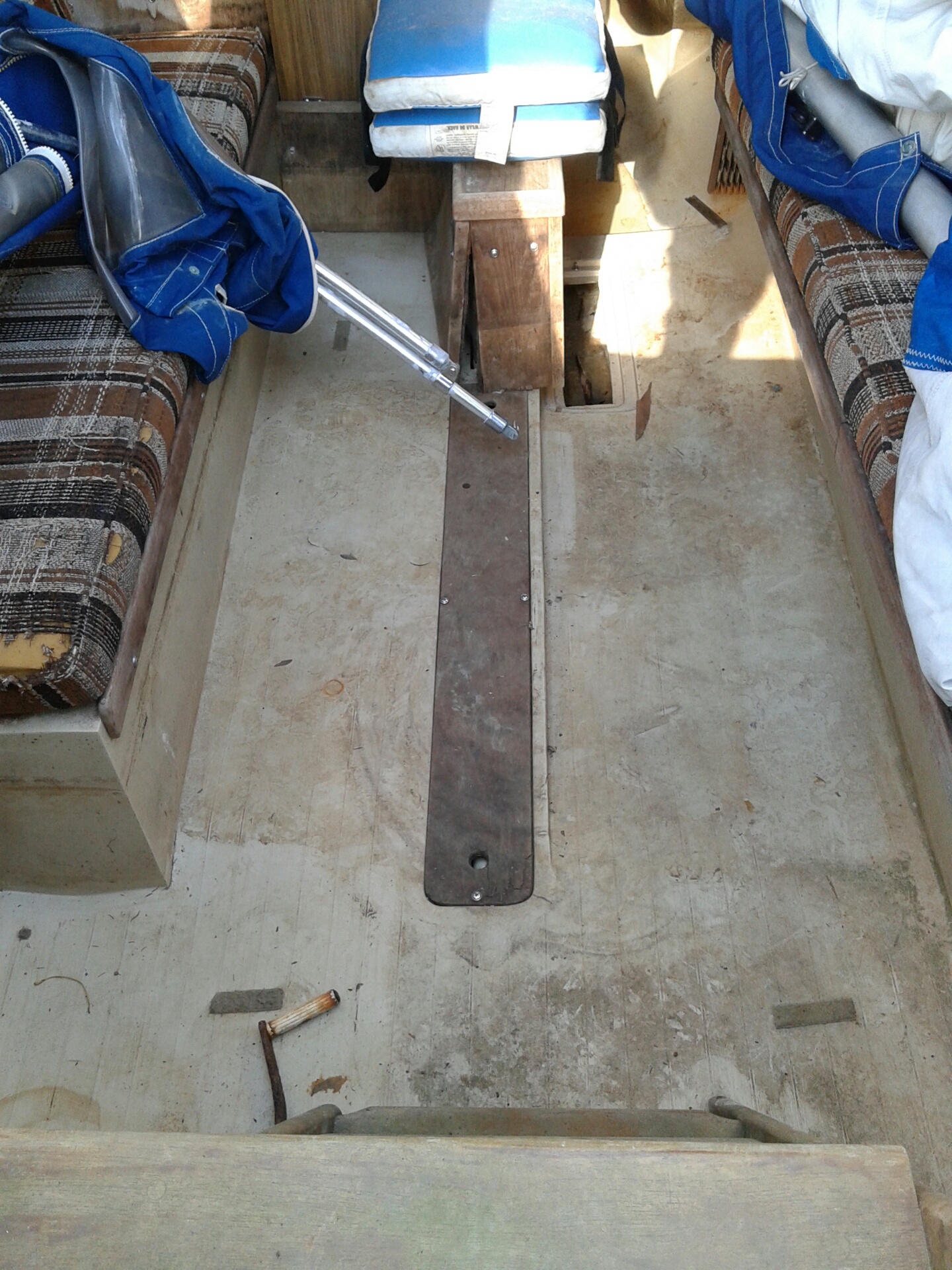

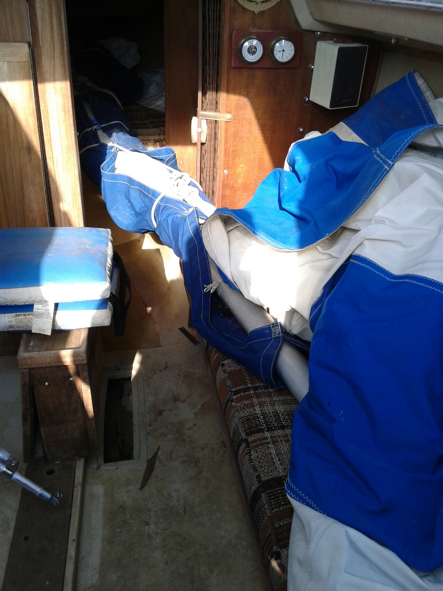

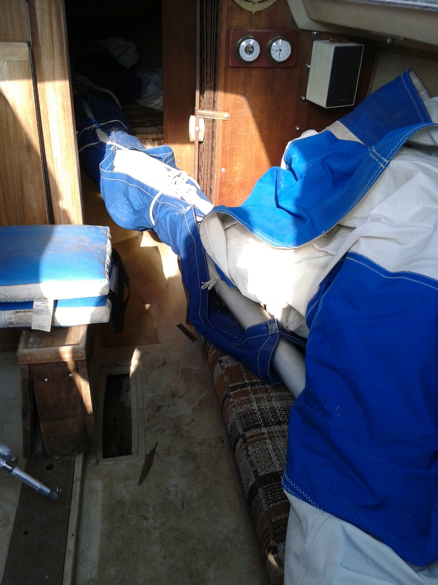

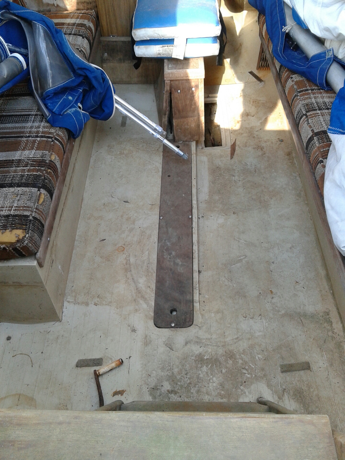

Here are a couple of pics taken inside subject C-25.
My guess it is some sort of cover over the keel trunk forward end. I have not seen this before. Can anybody tell me what i am looking at here? pic 1 is the total area of forward salon deck, pic 2 is a close up of the specific area in question.
