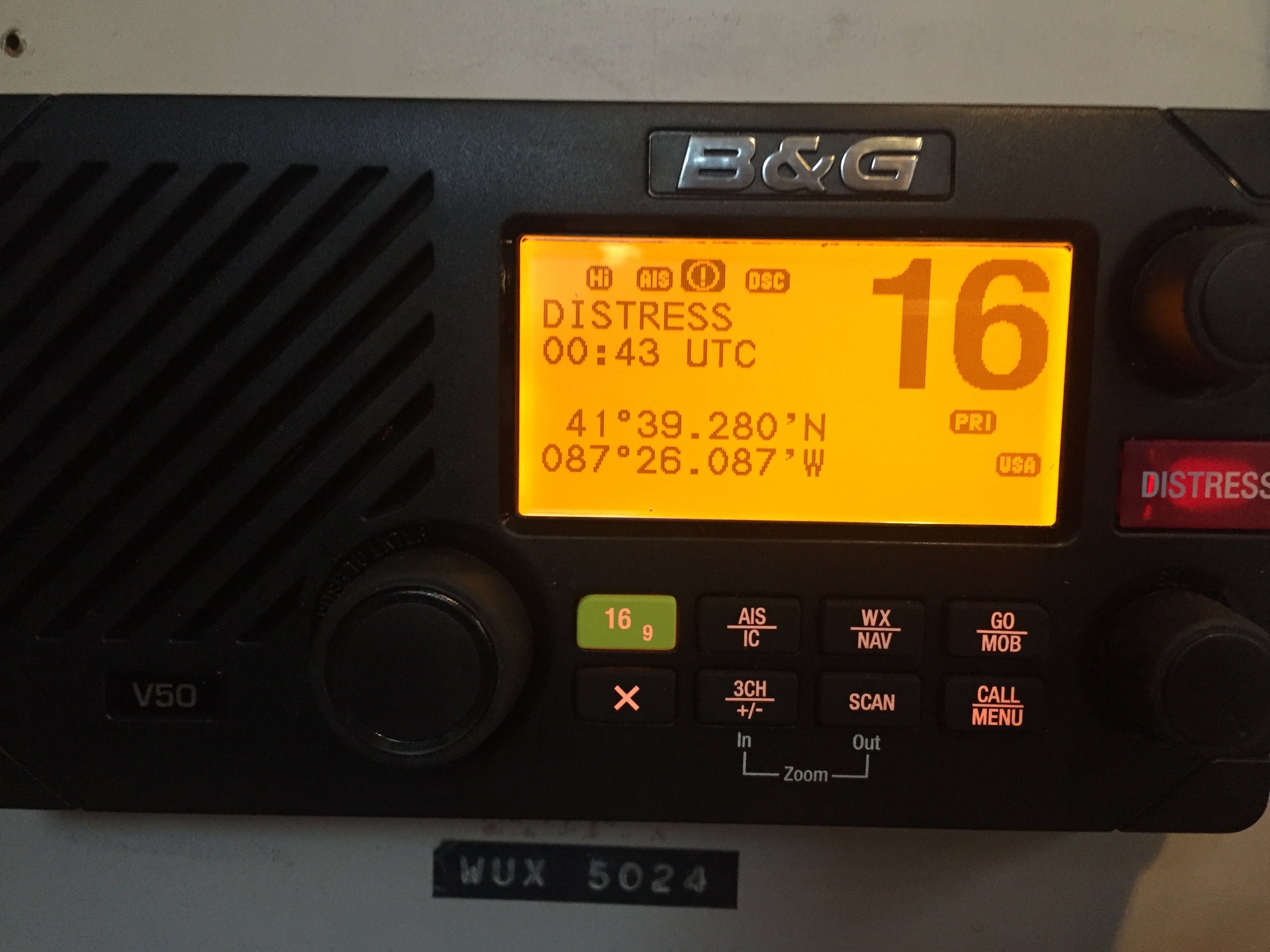

I had VHF's on my boat when I bought it. A newer Lowrance Link8 at the helm, mounted in a box low on the pedestal. Not covered, but we do have a canvas cover over the pedestal, when not in use.
The other radio, some ancient thing that did not really work at the nav station. The radios used the mast antenna, but you had to select which radio you wanted to use on a switch box. Not sure how much signal loss there was with this set up.
When the Link 8 bit the dust recently, I purchased a B&G V50 radio and the H50 wireless mic. I mounted the base unit at the Nav station, hooked directly to the mast antenna. The wireless mic has a cool induction charging base station. I chose to mount mine in the cabin (prevent it from being stolen, and being out in the weather (although it meets the latest waterproof standards). I will create a mount at the helm to hold wireless mic when I am sailing.
I have the radio networked to my Garmin Chartplotter so I can share GPS and AIS data between the 2 using NMEA 2K.
I tested the wireless out last weekend. Signal was loud and clear, the unit was loud enough to hear clearly and my radio check was responded to my another boat 10-20 miles away.

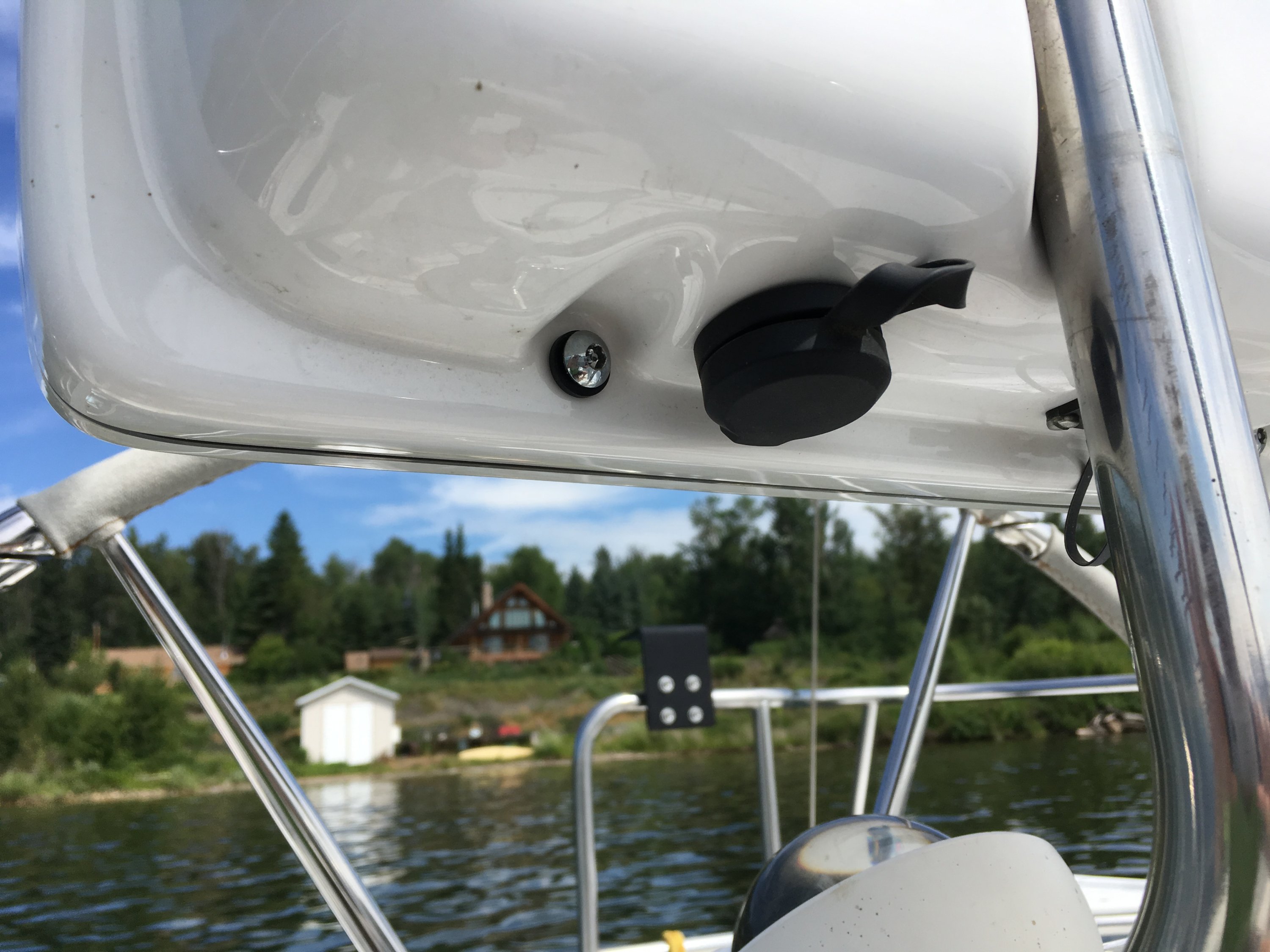

The Ram mic is the only way to do this. I put the plug on the underside of the NavPod, and routed the cable though the binnacle rail with the Ray cables.. so there's no cables hanging about.

I had a hand-held in the cockpit when my fixed-mount bit the dust. I just don't think you get nearly the range as a mast-mounted antenna.
I went with this combo as I wanted the AIS, and wanted to network it with my Garmin Chartplotter. I prefer the "plug and play" of a NMEA2000 network.
http://search.defender.com/?expression=b&g v50&s=1&Trigger=ac
The wireless mic works great.

I ran the Ray cables first, then this one, ad I cut the cable and soldered the ends back together.
The clip is mounted to a 1" rail mount. It's worked well for two years now.
