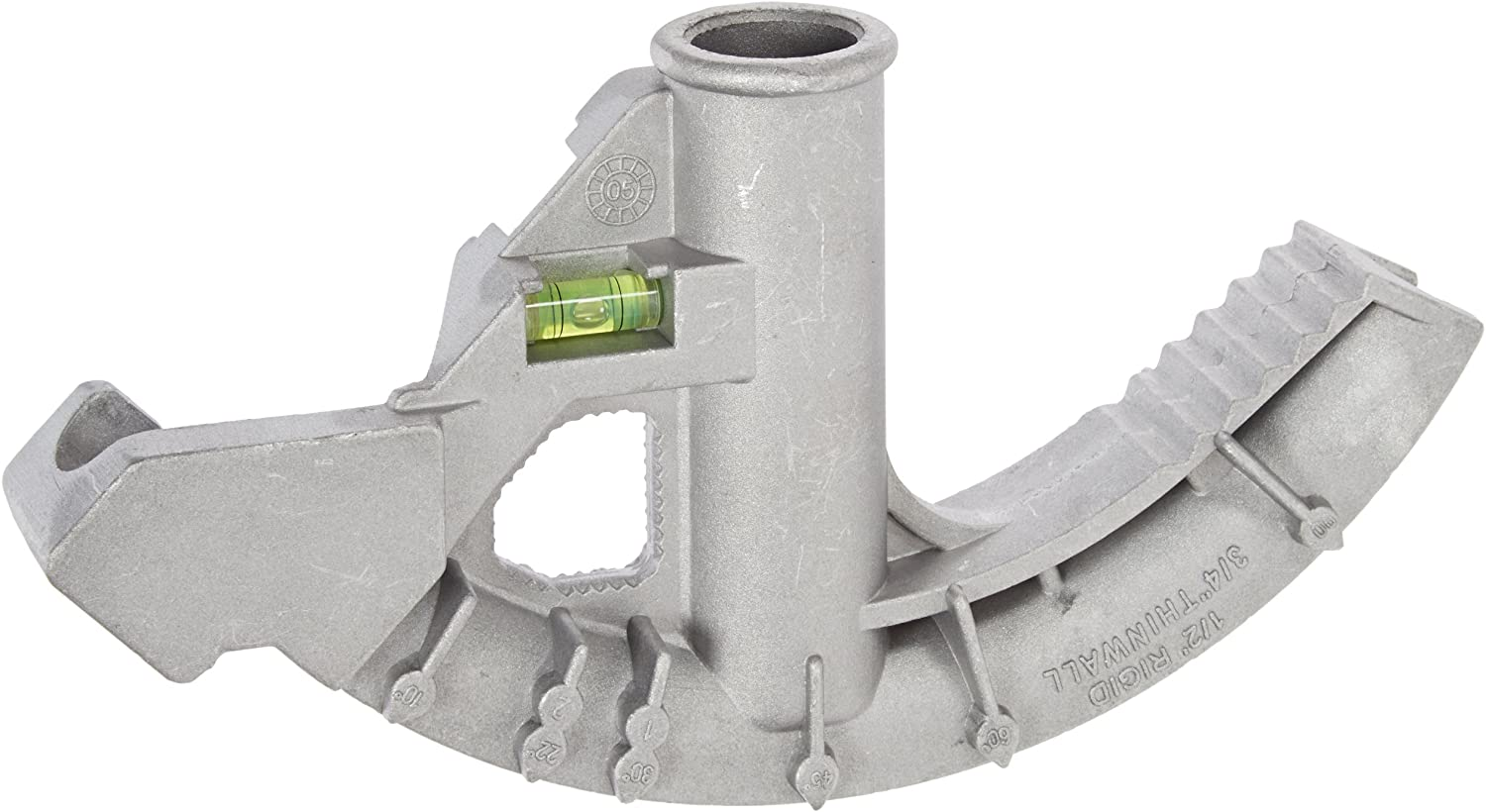

Will an electrical conduit bender work? You need 1" diameter. They are available at most hardware stores.

I think the bend radius might be too tight, but I will look into them

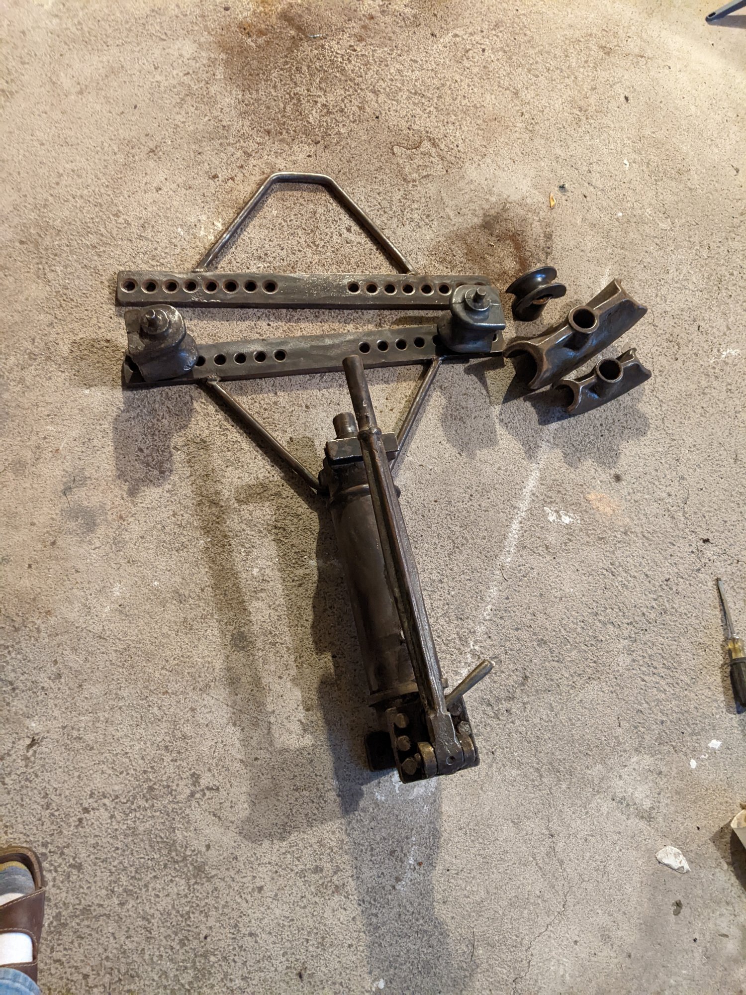

Interesting thread - I'm actually in the process of rebuilding my old tube bender - it's probably 50 or 60 years old, possibly older. Bought it in the 1980's and it was old then... I used to use it to build stainless structures for boats, Bimini's, rear solar panel platforms, that sort of stuff. A trick I was taught back then was to fill the tubing with sand, cork the ends and then bend. Helps to not kink the tubing.

I have a totally different kind of tube bender. Mine has a hydraulic piston that pushes a mandrel for the tube diameter into the tube which is supported on two sides. You can make any radius you want up to the limiting diameter of the mandrel, more or less. You can also make compound curves or long curves. Years ago I did hand rails that were close to 30 feet long matching the curvature of the boat. 316 does like lubrication. I liked their internal mandrel, I wouldn't be able to do that with my set-up. I can run large diameter, thick walled material with this bender also. I have to get all the seals redone - I hope they can find them... I want to start doing some boat projects... My Bimini really needs to be rethought and redesigned...
