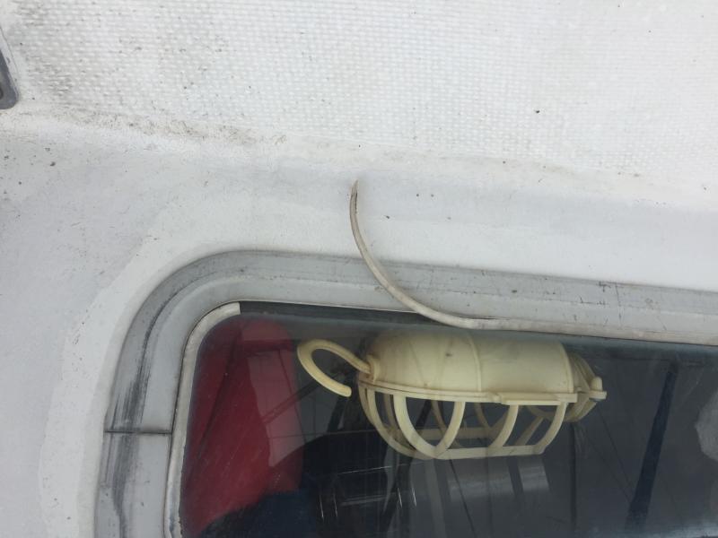

Good to know about the windows...I was thinking I could just re-caulk around where it is peeling out (see attached picture), but your suggestion sounds like a longer term solution and worth the effort.

On those windows the butyl goes between the fiberglass and metal. On the metal glass junction I would tuck that back in and use a good quality caulk like Boat Life. In the home improvement store you can get a little rubber trowel kit ( about the size of a credit card) or use one of those fake credit cards to push the caulk up into the seem. It will clean up nice and a little caulk will go a really long way. Do not use 5200 or you will regret it. Catalina Direct sells a window fix kit but is spendy and time consuming.
