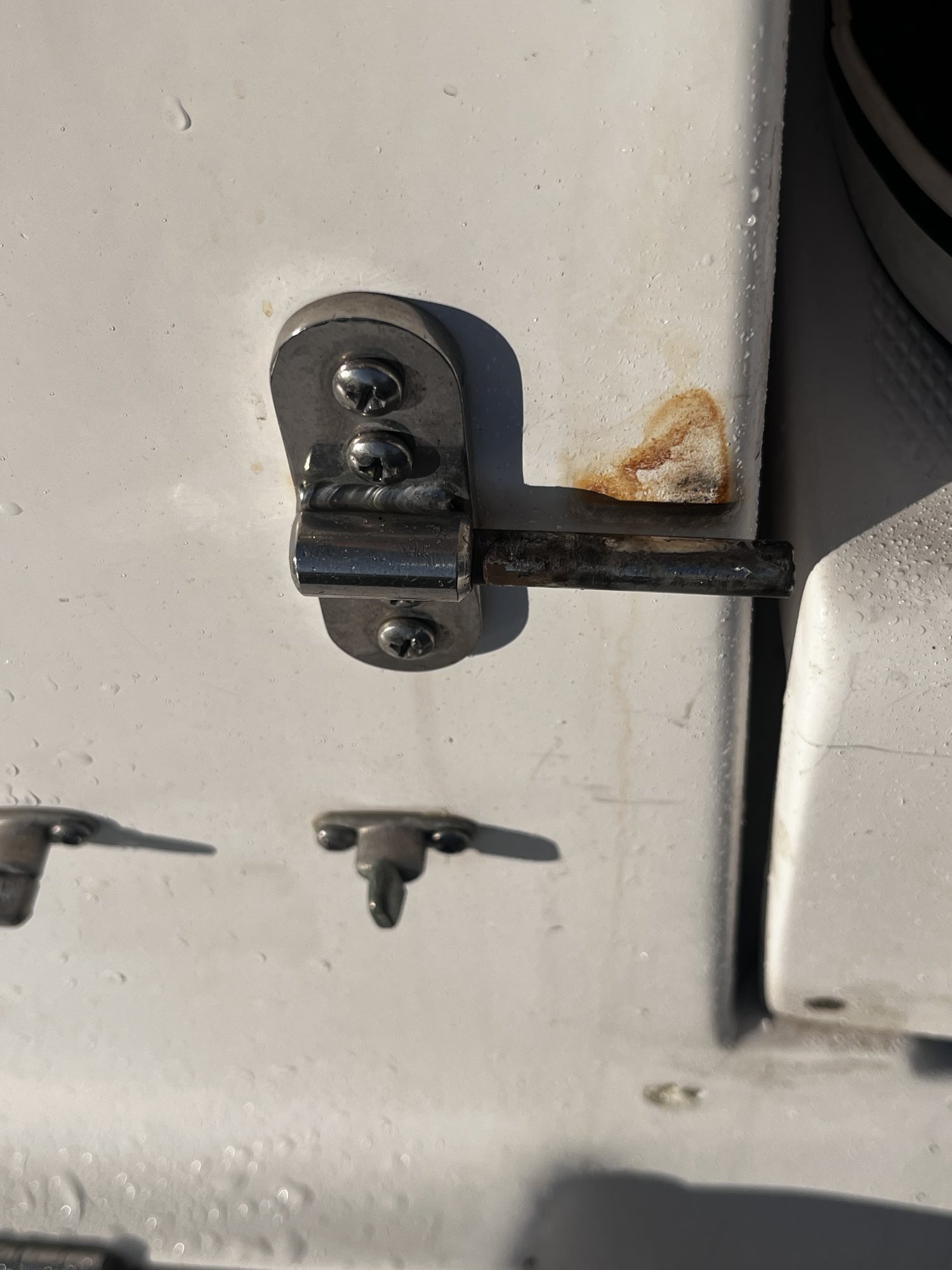

Hi - I've lost the pin and spring for the starboard side of this (still have the bracket but the pin is now with Davey Jones) The photo is the port side - need the starboard side. SailboatOwners is looking for me - they don;t have one. Anyone have any sourcing or replacement ideas ). I'd love to just find the pin and spring so I don;t need to remove and re-align an entire new bracket - but will if I have to. Any Ideas ?

Could you please explain what this fitting is? The title implies connection to something, but maybe a picture of the unbroken one would help, too.

sorry for the delay - it holds the stern helm seat that lowers down into part of the swim platform -

Contact the forum store. Most of the staff used to work for Hunter. If that doesn't work, look at pintles at marine hardware catalogs/websites

My hinge also came apart. The pin is 5/16" and could be made from a 5/16" SS bolt. On mine the weld broke and the pin migrated out. I was lucky and caught the pin before it exited totaly. Then had the pin rewelded into the piece and reinstalled on the boat.
