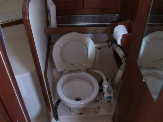

If you look at Renasci's photo of the head floor, you can see why I listed "compact base" as a requirement. There is a really irregularly shaped floorpan and there is little room for a head such as the Raritan Marine Elegance. Thetford's Tecma easy fit is one I have looked at online, I need to do some measurements to see if it can be made to fit with an adapter. I do like the idea of these residential style heads, but I'd like to know if there are smaller-based options that might not be as heavily sold or well known.

However, what I'm looking at in that photo isn't the hull...the back of it may be, and the bottom half...but the top half of the white thingy has a lot of space inside it. Whether or not it's empty is impossible to tell from the photo. What's to the right that has the power tool sitting on a big block of wood on it? I don't think that's hull either.
But that's neither nere nor there...it's the size of the platform at the bottom that matters...and I suspect you could build out a little more of a shelf for a toilet to sit on.

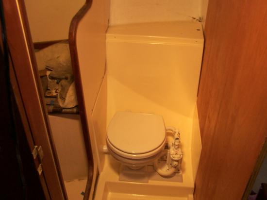

That picture is from a project in the H37C modifications forum. The original head installation is like the picture below. Except that the original hose run was behind the head, nothing like we see here. Mine all run behind a teak panel. The second picture is the end result of the same project. The owner, Renasci, simply wanted a fiberglass bulkhead to hide the hoses.
The original holding tank was just to the left and under the shower seat. Most of those are long rotted away and have been replaced with "plastic", usually in the v-berth locker.

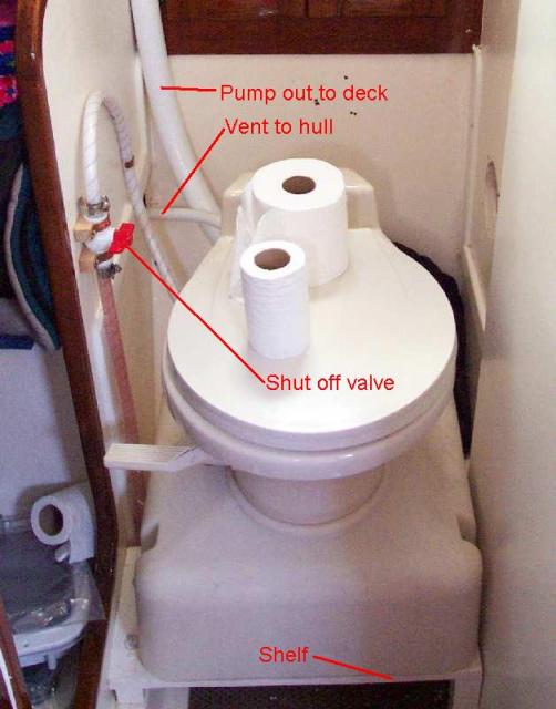

I built a platform
There is actually so much space I built a plaform and put in a Sealand with integral tank. This is seriously bullet proof but a bit short on capacity. I decided that realistically I would always be pumping out so I did'nt install any Y valves etc and eliminated a lot of ugly piping running around the boat.

I'm getting ready to install a new head on my H37c and had the idea of building a platform also. Wondered if anyone else had done so and you answered that.
Are you happy with the installation? Any downside? Lessons learned?
