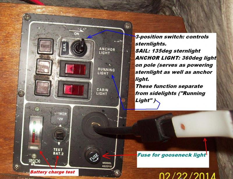

That said, I added a system to my DS II, powers NavLights (separate sidelights/sailing sternlight/all-around sternlight), light on compass, lighter socket for accessaries, and a small "map light" on a short gooseneck that I built into the panel. Presently my VHF Radio plugs into a lighter plug (remotely located below panel), might finally hard-wire that this Spring.
I bought and modified a pre-made switch panel that included a battery level meter.

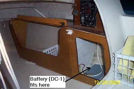

I originally used a "Group-24" dual-purpose battery (can be used for starting and Deep-Cycle applications) but have since replaced that with a DC-1 deep-cycle battery (same physical size as a UC-1 garden tractor starting battery) it has worked fine for me, but I don't have any cabin lighting and have not really done any nightime sailing since adding the VHF, so I can't really comment on the time between needing to recharge that battery (I'm on a mooring and bring the battery ashore when charging).
My battery is just inside the cuddy, on a boat with cockpit locker like the 19, I would most likely mount the battery (in a box!) there. I made a box to house my Battery, including a cover to protect the terminals from dropped objects. Unfortunately, the battery and box were not in place when I took the picture.

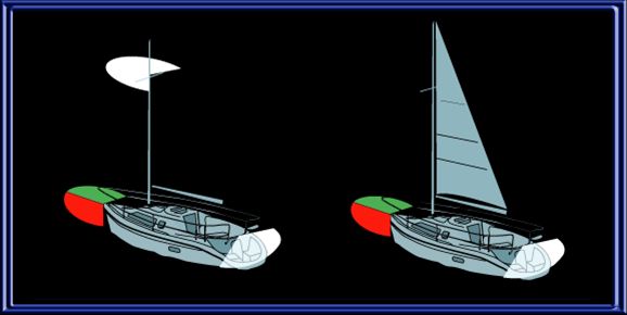

John has given pretty good advice above, the only thing I might add is to be sure that your NavLights meet the required configuration to avoid possible confusion by other vessels. Remember, you will need to be able to display proper lights for a sailboat while under sail and for a powerboat while under power (basically the same, except for need for a steaming light on mast while under power [225deg forward white light at least 39" higher than sidelights] or, like me use a 360deg white light on a pole [or at the masthead] the 360deg light will need to be switched to allow use with or without the sidelights, but must be setup so the sailing sternlight is not on at same time, I use a 1-off-2 switch with the sailing sternight as #1 and the 360deg light as #2, that way I turn on whichever sternlight is proper for the situation. Steaming light would be used at same time as sailing sternlight while powering (sailing sternlight is 135deg white facing aft, so 135 + 225 = 360) I included a picture of the proper configuration, the sidelights can be separate, the combination is one option, and the setup that I have, using the 360deg white light for a sternlight under power isn't shown.
Confused yet?? Don't be..... it isn't as complicated to do as it is to describe!

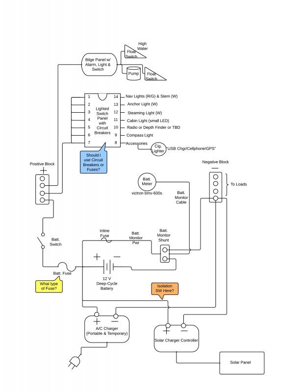

Thank you both for your insight. I've been doing a lot of reading (online & books), and I'm slowly pulling together my system. I still have a number of questions. Appreciate any insight you (or anyone) might have.

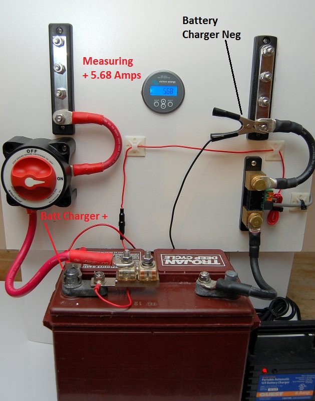

Here is my concept at the moment (see wiring diagram attached). I started with a Victron BMV-600S Battery Monitor as outlined by Maine Sail (http://www.pbase.com/mainecruising/battery_monitor) (see attached picture), added in the A/C Charger(tbd-will not be an automotive chgr from what I've read) & Solar Panel(Ganz)/Controller(looking at the Genasun), added a Bilge Pump Panel w/ Rule Pump/Switch and High Water Alarm. I'm not sure how big a Switch Panel to get. I want to make sure I have some room to grow. With this configuration I need a 7-8 switch panel, but that seems like a lot. I'm wondering if I can combine more than one piece of equipment on a switch.
Here are my questions:
1) A Group-24 battery is quite large. I'd rather go with a U-1 battery instead. As a trailer sailor I won't be cruising days on this setup, maybe an overnight or weekend. How do I determine if I can get away with a U-1 battery instead of a G24? Based on my calculations, with everything running, I will be pulling about 25AH(?). It appears that there are 35AH U-1 AGM batteries. Can I get away with a U-1 AGM Battery?
2) Does the Solar Charger Controller wire directly to the pos(+) and neg(-) of the battery? Should the neg(-) be on the other side of the shunt? Is there some type of switch or fuse in the line?
3) How do I spec out the Batt. Fuse that's required to be within 7" of the Batt? Do I need to add up the draw of all of the loads and figure out what the maximum current draw might be? Is there a good rule of thumb based on the size/type of Battery?
4) I see that there are Switch Panels with Fuses and Panels with Circuit Breakers. Should I go with Fuses or Breakers? Should I go with Fuses so I can change the sizes of the fuses based on the individual equipment being switched? Do all of the switch panels that offer circuit breakers all use the same size breaker?
Thanks for your help

Nice wiring drawing.
The best way to fuse the battery is to get a post mounted fuse assembly. These are not very expensive and are easy to use.
Size the fuse for a worst case current draw (everything on at once) then provide some headroom 10-20%. I use an electric motor so I have a 120 amp main battery fuse.
Each of the circuits have their own fuses sized for the particular devices on that branch. 10 to 15 amp Is typical for a branch.
The Group U1 deep discharge size will be sufficient for most trailer sailers. But make sure it is not a "starting" or "dual purpose" battery. It won't take the deep discharging well and will need to be replaced much sooner than you would like.
I connected the solar charge controller and the external charger directly to the battery with no additional isolation.
