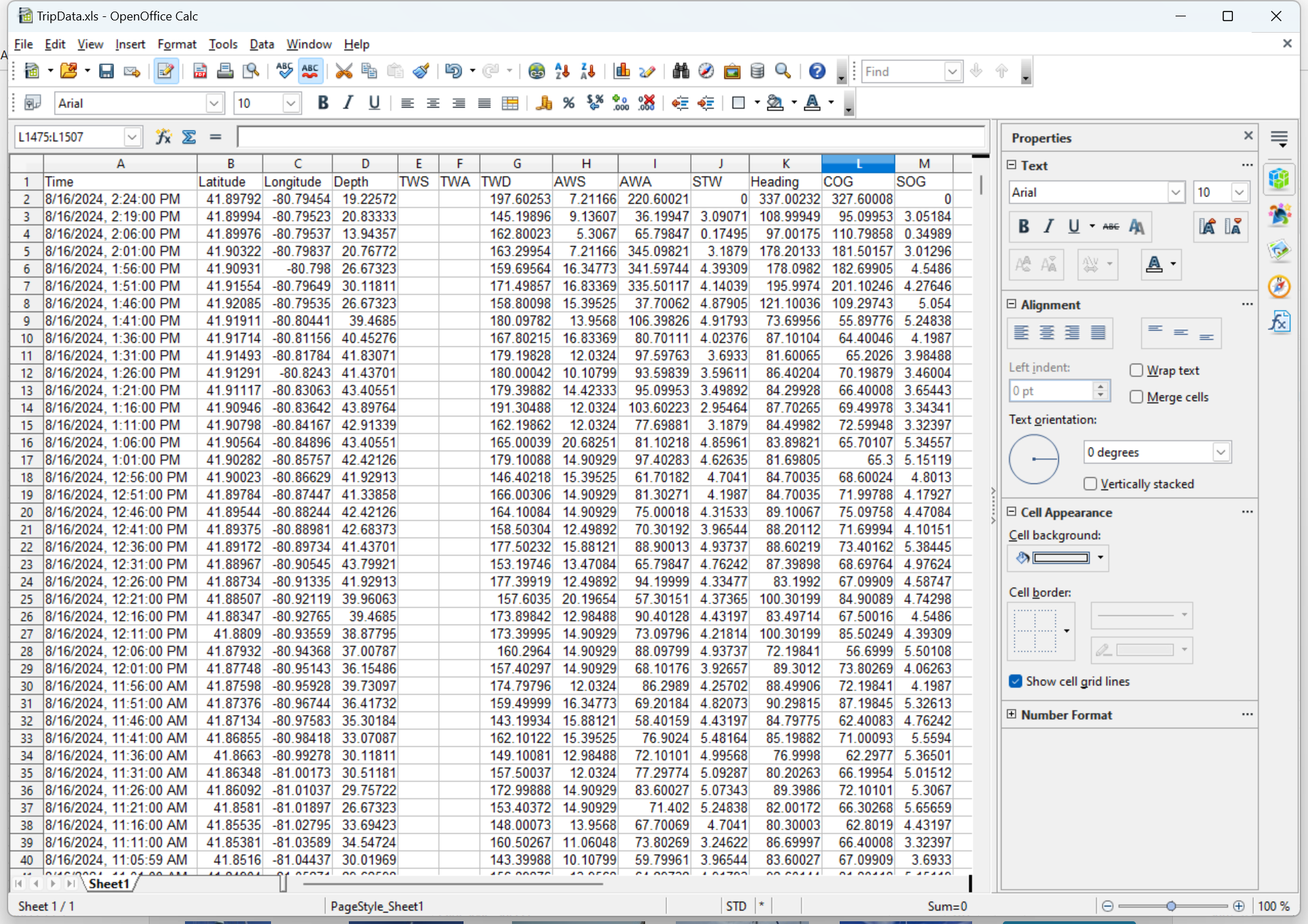

I have data files that have lat/long and other data recorded every 5 minutes. I'd like to process this data to get various interesting data, such as total mileage, mileage per day, avg speed, etc. I've tried google maps, but it doesn't do any of the analysis. I've tried GPX Viewer and Record (Windows), but meh.
Any suggestions as to other software? This is just for fun, so free is good.
I have several years worth of this data. Eventually I might try turning it into a set of Polars that would exactly match my boat/sails/style, etc.
Here is a screenshot of the type of data sets I have.

Did you try OpenCPN? I don't know how many data points you have in that set - I'm only seeing 41. I'm sure there are a number more... I'd think actually setting up macros in Excel might be your best bet.

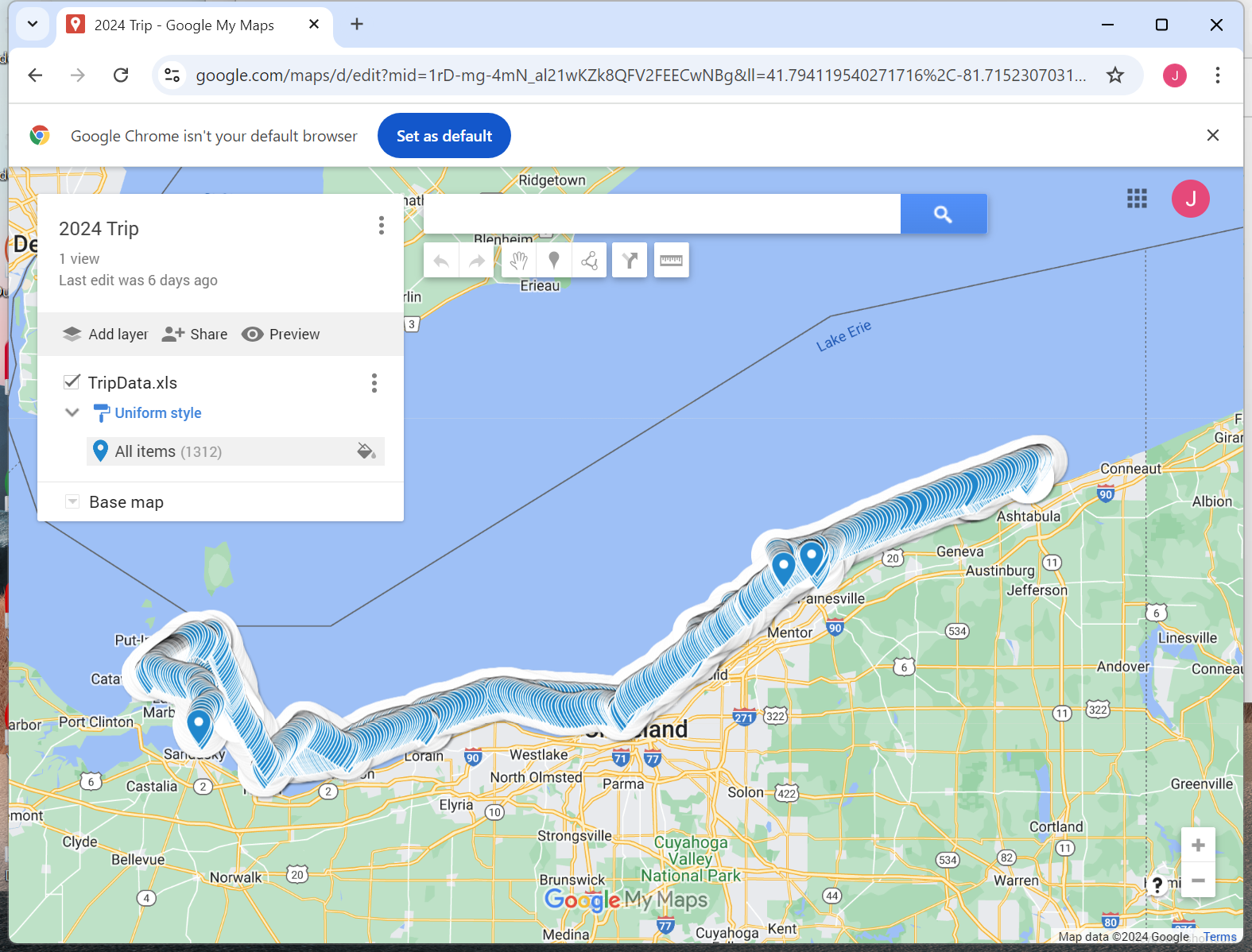

I can write the code to analyze it, but I would have thought it was a pretty common thing so there would already be software out there to do it. I can map it, but that doesn't give me much info, just a billion points.
