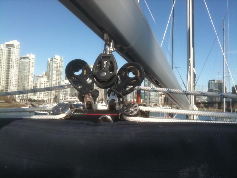

I have a special Harken doubleended mainsheet arrangement that led the mainsheet down on the two sides of the arch. It works great in that it does not interfere with the traveller movement as Hunter's standard arrangement would. Works good but I hardly ever adjust the mainsheet now that the twist that I want is always there.
