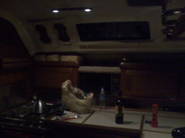

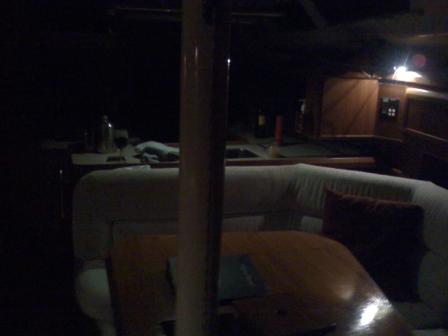

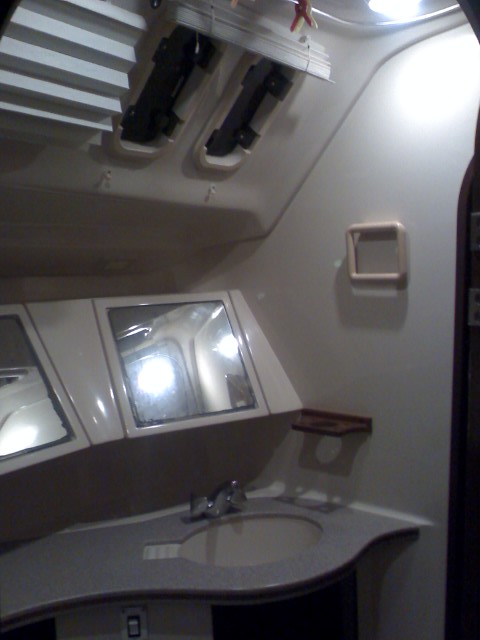

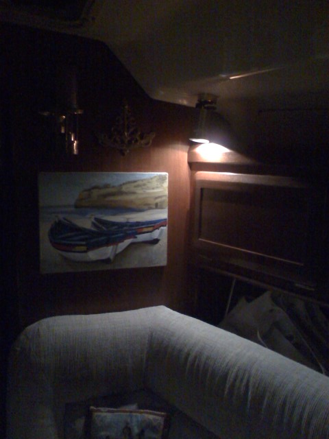

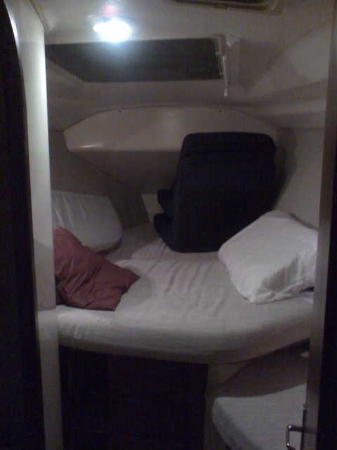

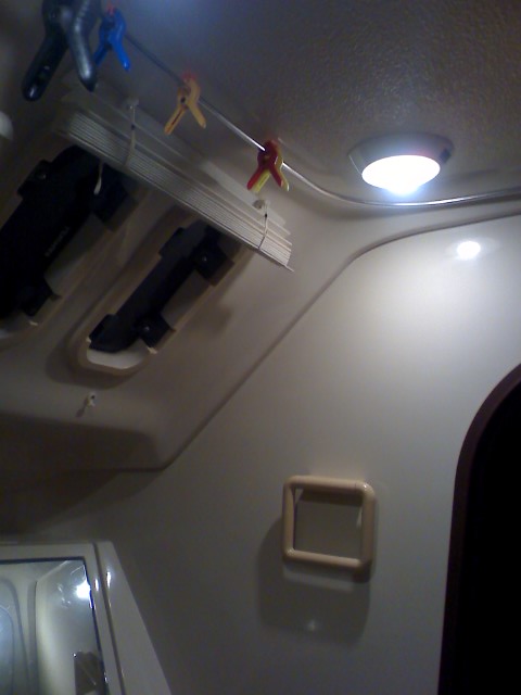

I have installed those superbrightled.com in mine. Very brigh and nice. You loose a little bit since they point down and a normal bulb is reflected in the assembly itself. Head and V berth are that type, Salon are sensibulbs.

Great pix! That is just what I'm looking for. Just enough light to move around in the dark. The LED bulb over my table is bright enough to read by. The bulbs to replace he dome fixtures should be perfect.
