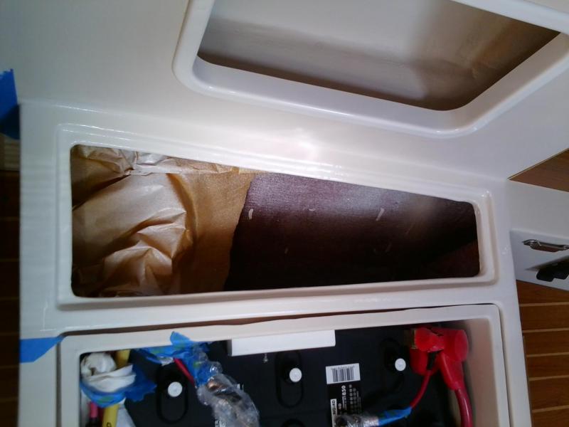

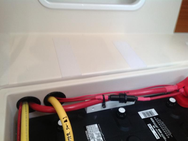

One of the reasons this has taken so long is because I had to make room for the Buss Bars, Echo Charger, Alt maintenance switch, shunt etc by cutting a large hole in my brand new boat:eek:
Here is the before and after:
