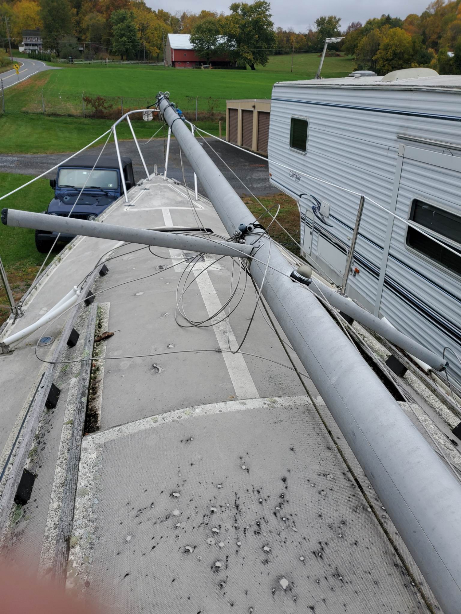

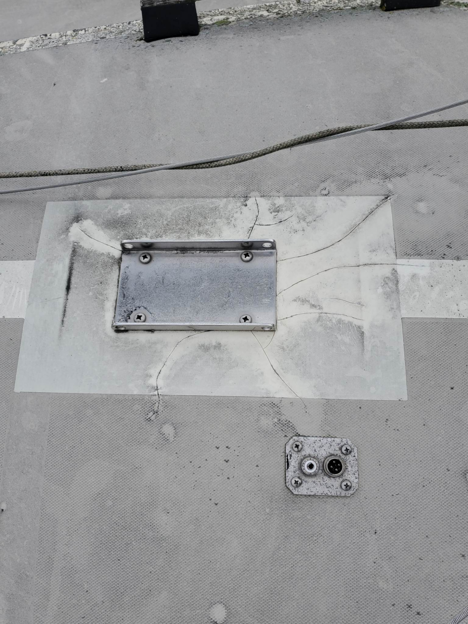

Hi! A friend and I are looking into getting into sailing. We found a 1984 Oday 26 with new rigging and sail as well as its on a trailer! The boat itself seems okay, it has a centerboard keel and had a inboard motor that has been taken out and replaced with an outboard option. My only concerns is this cracking in the gel coat on the deck. The Interior seems dry and well but I just dont know if this will be a issue. I would like your feedback and see what you think. Btw the rest of the hull seems really good, no other cracks and the inside is completely dry!
and any tips you would give to a new sailor would be appreciated

This damage is a little concerning. Gelcoat cracks are typically not a big deal, but this one might be. One of the causes of gelcoat cracks is flexing of the gelcoat. The mast step is under a lot of pressure, if the deck underneath it is not firmly supported it will flex and could cause the kind of crack you see. There are three places that need further investigation.
The deck itself is likely cored with plywood or balsa wood. If the wood gets wet and rots it will not support the mast and the cracks will form.
In the cabin, there should be a bulkhead immediately beneath the mast step and there should be a heavier piece of wood running vertically from the top of the cabin to the sole. The purpose of this bulkhead and wood, more properly a compression post, is to transmit the downward force from the mast to the hull structure and keel. Look carefully at this area for damage or rotted wood which can no longer support the forces. This will cause the deck to sag a little which will cause the cracking.
The boat likely has a fiberglass pan that serves as a cabin sole. In the area beneath the mast and compression post there should be some support. If this support is damaged, then the compression post can settle and the deck sag. You may be able to see or feel beneath the pan for damaged wood. If this is damaged, then the deck sags, etc.
The looks like it might have been repaired earlier. The white gelcoat does not quite match the original gelcoat.

Those cracks are below the mast step, it appears, which is not a good sign. We get these questions all the time and you are going to get a lot of answers that go into depth about how to choose a boat and how to make repairs. The opinions are going to be all over the place, I'll predict! ;) So I'll give you mine ...
We only see one picture of a very limited view. It's not a good sign. A critical area is cracked, which indicates a soft cabin roof. The deck is very dirty. We can only imagine the disaster that this picture may represent. If you are interested in sailing, find a way to sail on other people's boats until you know more about what you like. You'll get to go sailing and you won't have maintenance and repair projects on a 40-year old boat.
If this boat isn't costing you anything and you can dispose it easily when you figure things out, it can't hurt to sail this boat for a while. If you really want to spend money and time on maintenance and repair (many sailors love this aspect of boat ownership, me included), you've come to the right place for advise! Give us a bigger picture about what you and your buddy want to do, where you want to sail, your skills, and most importantly a bigger picture of the boat's condition and an avalanche of answers will come your way!

As Scott said, the stress cracks it themselves are common on old boats - it’s the consequential moisture damage which is the problem and can be assessed better by a person competent in using and interpreting moisture meter readings.
what appears at the top is more troubling - an unsealed or poorly sealed chain plate (to which the rigging attaches). Rot there can be a show-stopper.

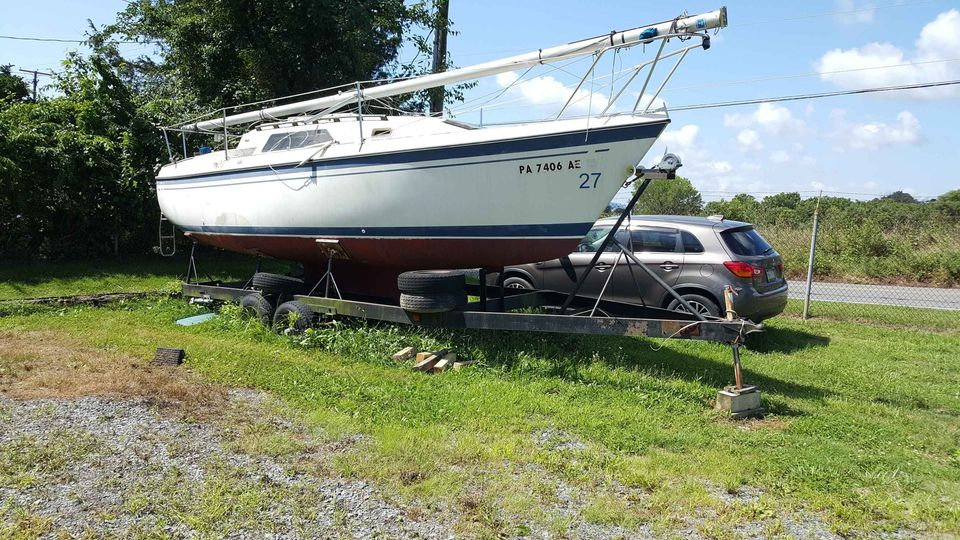

Is this the boat on SMG from Sterling, Mass? If so, your picture doesn't do any justice to it, I think. OTOH, the ad has only 3 photos and no description so the ad doesn't do anything to help describe the boat, either.

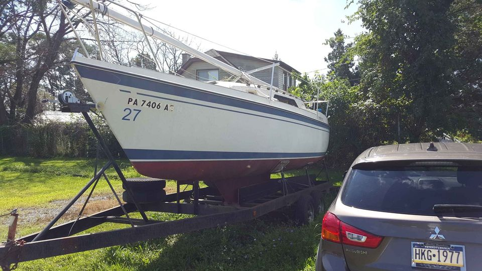

This is the rest of the boat, in the listing he does mention that he had torn the carpet off the bulkhead, repaired and painted some parts. I quote "New teak bulkheads installed about 15 years ago"

That boat has the look of neglect and it doesn't appear to have been recently cared-for or sailed. I don't really get what the number "27" is all about. Is that a Lake Wallenpaupack boat? I know they have some dedicated sailboat racing up there. Perhaps it is a boat that was sailed a lot in the past but not recently. Depending upon your budget, I would be a little more critical in your selection. There isn't any reason why you can't find a boat that has been better maintained. If you reside in NE Pennsylvania, I understand your need or desire for a trailerable boat. There should be quite a few available if you expand your search in that area.
I'm not too sure about the 27 either, but I do plan to sail on the wallenpaupack. Trailer-able is the main key so I can bring it to other lakes, I think I will look a little farther and see what else is out there. Thank you for the advice!

As observed by @dlochner concern about the location of gel cracks under the mast step is at least a 4 out of 5.
As @Don S/V ILLusion mentions the gel cracks on the surface leads to an inspection of the structure underneath. Gel Coat serves as the water barrier between the inside and outside of the boat. The boat primary purpose is to "Keep the Water outside of the boat".

Looking at the additional pictures, I would conjecture:
  • the 27 leads me to believe the boat was used in a fleet of rentals. Either a youth program or a lake boat rental operation.

If you can find a 40 year old boat without cracks in the gelcoat I'd like to see it because that ain't gonna happen. The big questions is: Is the deck soft? When you setp on it does it feel soft? Does it give? If it is solid then do not worry about it. The boat is 40 years old.

It is very solid on top, also I'd like to see one too haha
