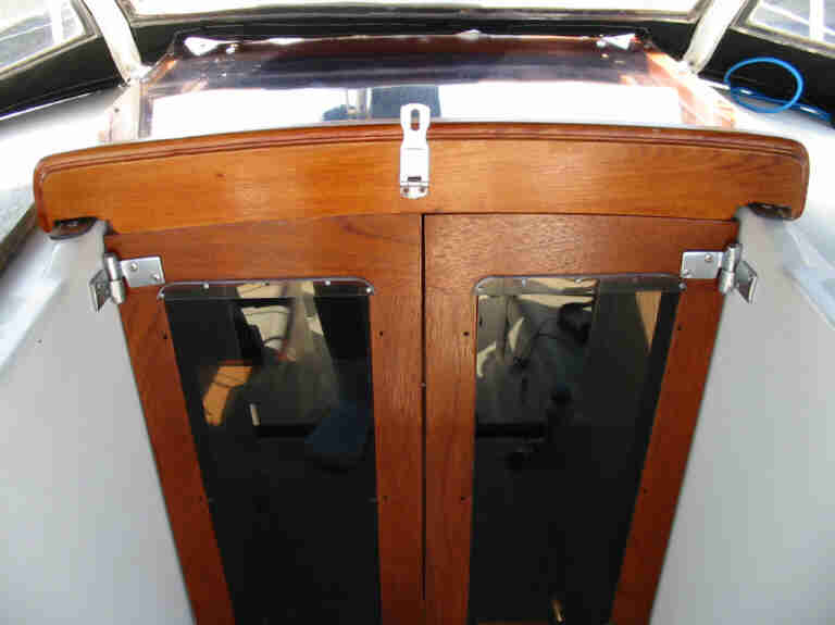

How about doors out of Starboard?
I made doors for my previous boat (H29.5) and am in the process of making doors for my new boat (H410) out of Starboard. It's very easy to work with and is really no maintenance. On both boats I was able to position the doors so that they allow the use of the hatch boards (on the 29.5 it was a one at a time situation, the 410 has enough space that they can both be used at once). I have a photo of my first rough fit on the 410 (the doors are just laying in place so please don't criticize the fact that they look uneven - they need to be adjusted and trimed to fit and fastened in). I will try to attach the photo to this message.

I made a pair of doors out of mahagony with tinted lexan inserts. Behind the inserts are permanent screens. I used a "lift off" type hinge. These doors have been the single greatest improvement to our boat. Residing under the dodger, they will probably not need refinishing for quite a few years. Any questions feel free to ask. Don sailbode@gis.net

Bruce, any tips on Starboard?
Bruce, I like what you did with the starboard doors. What thickness starboard did you use? Any other tips to share? Any other photos? Thanks, Gary
B
Bruce Mulford
Reply to Gary A.
Gary, thanks for the comment. As I said, this is my second set of doors and the first was a learning experience. I used 1/2 inch thick starboard. The starboard cuts easily with a fine tooth (plywood or plastics) blade in a circular saw and can be sanded, routed, shaved with a knife, etc to fit. The best tip I can give is to plan it out very carefully first - the old "measure twice cut once" philosophy. Be sure to consider how the doors will lay when opened (on the 410 I had to provide a non swinging edge so that the hinged part will clear and lay flat against the sides). Also, look at how you fasten them to the boat (both boats I've done have only fiberglass shell around the door edges and the screws will show on the inside). Watch also how the sliding hatch will fit over the doors (on the 29.5 I had to fit the doors into the same slot the hatchboards go so the doors would be under the hatch, on the 410 I have a much longer overhang so they will be in front of the hatch boards). On the first set I tried various locking hardware, none of which I was really pleased with. On the 410 I currently plan to have no handle or locking hardware on the doors and simply put the hatchboards in when I want to lock up. Goodluck if you try to make your own. Bruce
