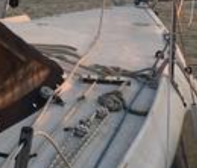

I can't quite see it, might be Schaefer, can you show it close-up?

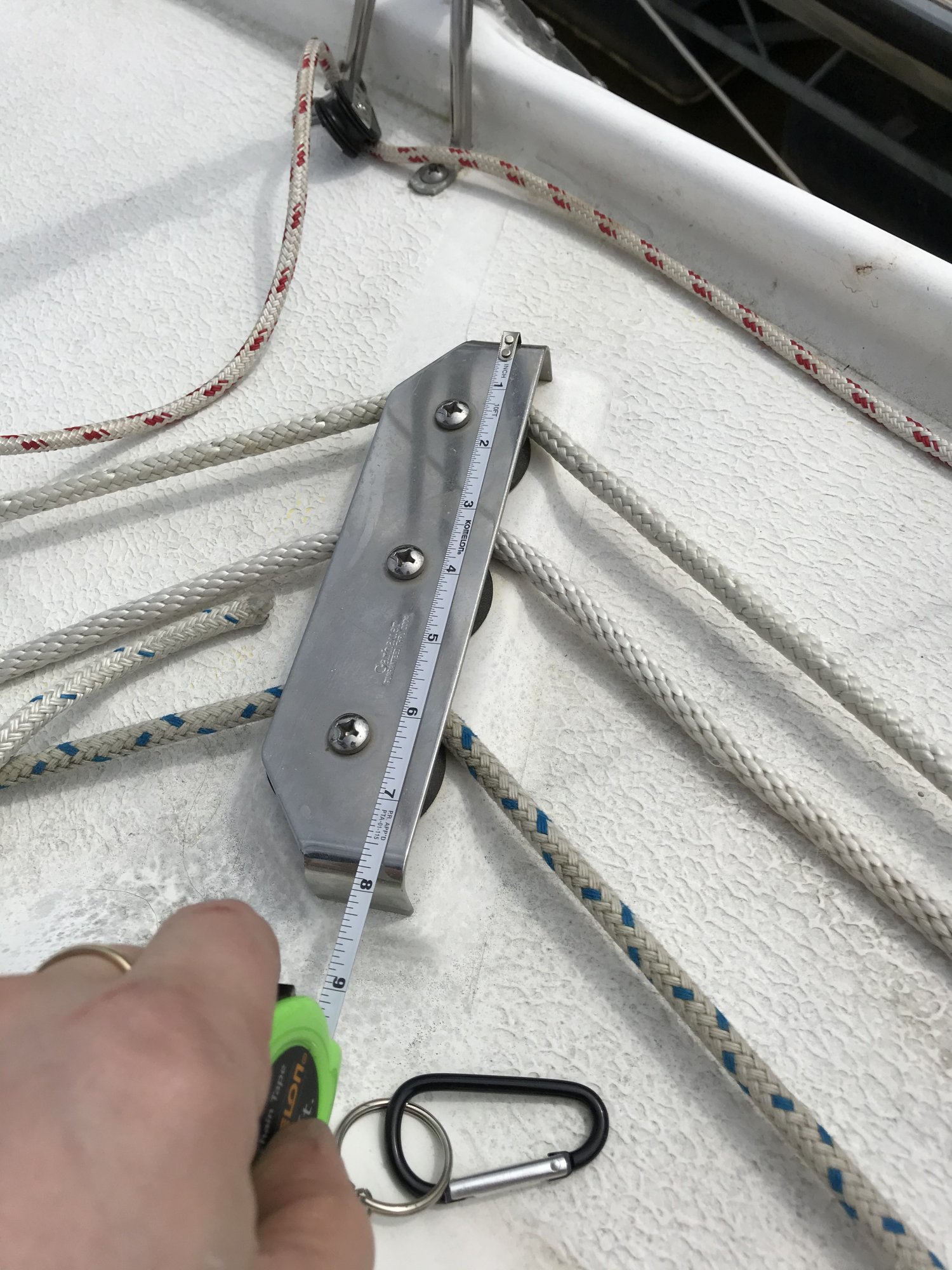

I'll snap a pic Saturday (maybe Friday night) and reach out to you guys next week. I recently ran all of my lines to the cockpit including the topping lift and my clew reefing line. My current organizer is maxed out and I have a few lines just running back to a cleat that could use some "organizing". I'd also like to add a down haul line for my main halyard. When trying to reef from the cockpit, I occasionally still have to go to the mast and yank down on the luff because of a jammed sail slide. I believe with my clew reef line and a down haul I could easily release the main haylard and use those two lines to affect my reef from the cockpit.

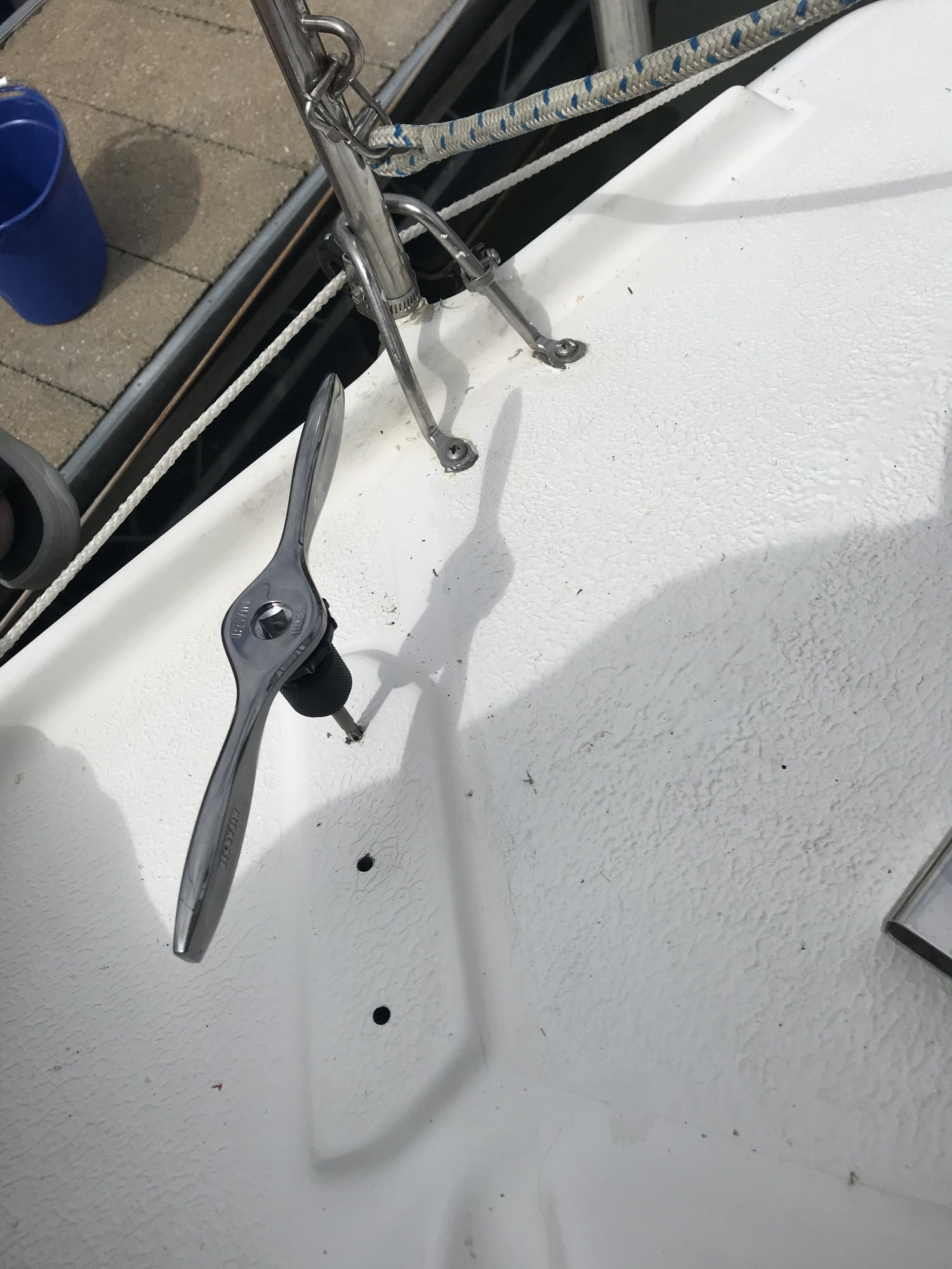

It looks like the H26 deck was cast with the same embedded "backing" plates on the port side as seen on the starboard side for the organizer and clutch but... the port side is empty. I'd like to tap and dye some threaded holes and attache an organizer to port and maybe some clam cleats or another set of clutches.

I found a few more examples online. This first one definitely looks like mine. Silver with black sheaves.

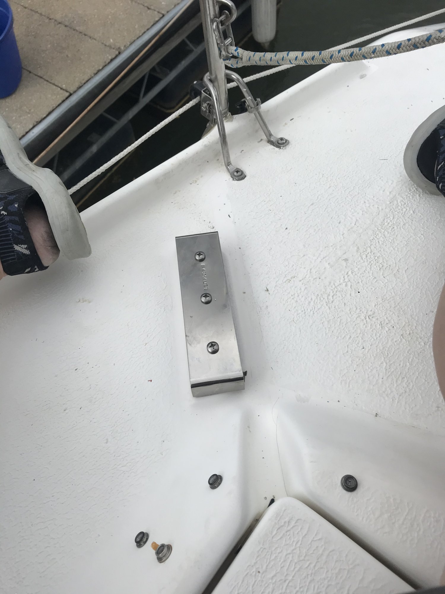

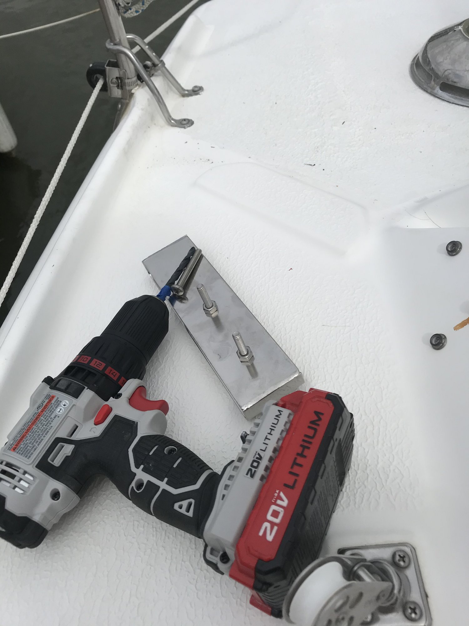

Found something close at Carolina express and installed it yesterday
now I have one port and starboard
