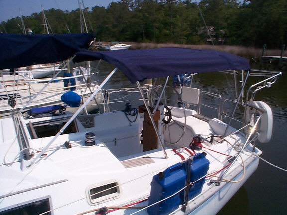

Gary A.
Bimini Photo and a Question For Susan
Here's a photo of the 4 bow bimini on my Hunter 34. The height is fine for a 6' tall person anywhere under the bimini. The boom never touches the bimini, but when the sail cover is on, it hangs down low enough to rub the leading edge. I usually use a spare sail tie to wrap the very end of the sail cover up a little tighter and it clears the bimini fine. Someday I'd like to add a dodger, but in NC it isn't a priority. Susan, can you tell me what the small round fitting is on your starboard transom (just outboard of your fuel vent)? Looks like one of those hand-held showers or perhaps a municipal water inlet. Thanks! Gary
