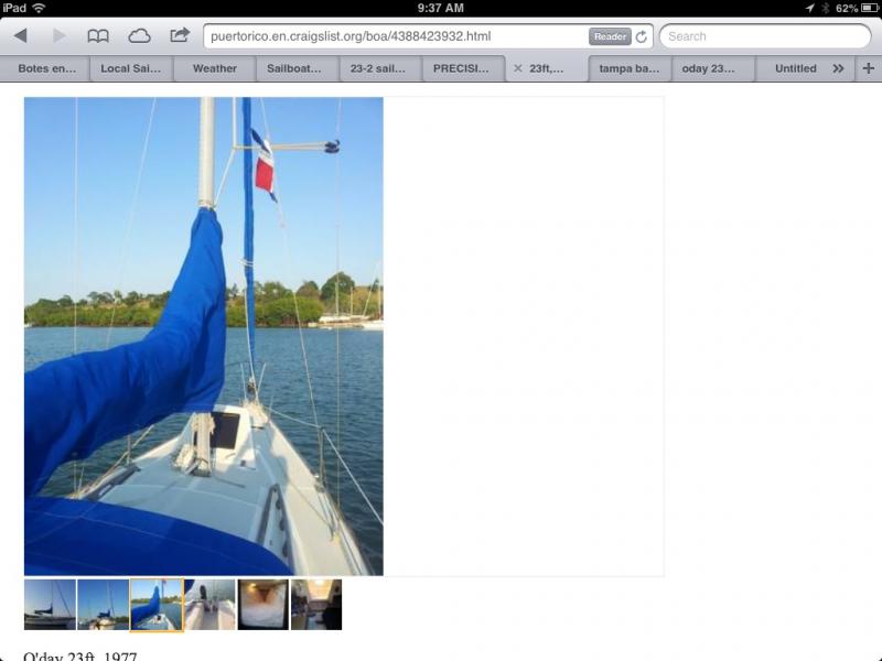

Hi there. I am looking to purchase a 1977 O'day 23 in Puerto Rico to do some island hopping. It seems in good condition from the pics - the owner is sailing it from Dominican Republic - it should arrive in a couple of weeks. Is this a good boat for mostly sailing within sight range of islands like Culebra, Vieques etc. I am relatively new to sailing, but I have gotten 101 certified. Also, I won't be alone. I am sailing with a friend with the same level of experience.
