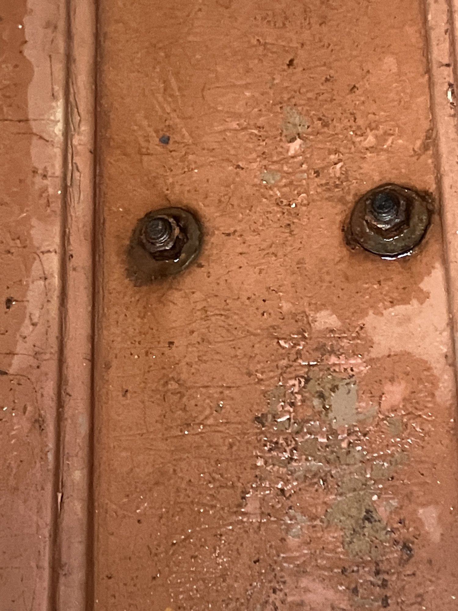

I got another look at the boat. Keel bolts look like this - is replacement recommended?

Replacing keel bolts is a major repair.
Not on a Cal 20 it isn't. Again, I'd recommend getting in touch with the folks at CBYC. There are people there who refurbish Cal 20's and do this all the time. I'm sure they'd be happy to pass along any helpful hints as well as info on sourcing the bolts, torque specs, and whatever else. It's definitely in the DIY category.
13,589
How are the keel bolts installed in the keel? Threaded into cast iron?
Nov 22, 2011
1,283
Ericson 26-2 San Pedro, CA
If I recall correctly, they just go up through a flange in the keel that bolts to the bottom of the boat.
The bigger job is sandblasting the cast iron keel and epoxy coating it. But that, too, is commonly done on these boats.
13,589
That would make a huge difference in the job. It is an unusual approach to attaching a keel.
Nov 22, 2011
1,283
Yes, that makes it much easier. I just double checked and the bolts do pass through a horizontal flange.
