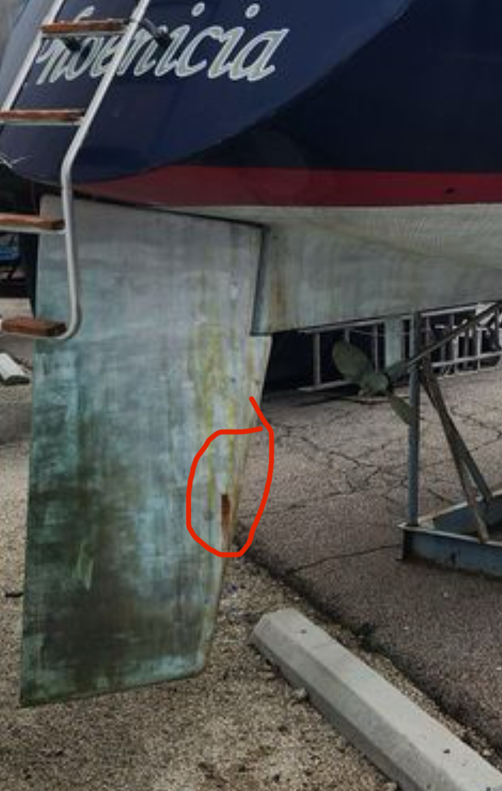

  1. Why would the hull have what looks like rust stains running down the hull?
  2. Dark stain on rudder scares me.

Most of the stains on the hull seem to start a few inches below the waterline. I’d guess they’re just some kind of organic growth from the boat sitting on the hard.
The one stain that would concern me more is the darker rust covered spot toward the front of the rudder.
If that one is really rust it could be water compromising the structure of the rudder and weeping out. It’ll take a closer inspection and survey to see what’s going on there.

as per Davidasailor's comment, the one I sailed on lost its rudder. Snapped off about 2 inches below the water line. But almost all rudders are at risk for that.

Thanks for the input, I think with a potential rudder rebuild and repower I might be better off buying a higher price/less expensive boat
