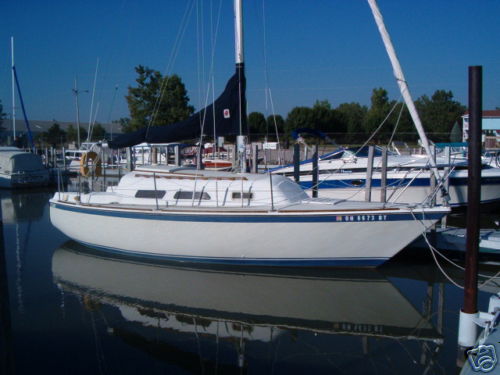

It just doesn't look like any of the pictures of the O'Day 28... It does however look just like a 27. The layout inside iS the same as the 28. PLUS it has an inboard, were "all" the 27 powered by outboards?

Sunbird22358 - Thanks for the response... I'm not why the difference, but the 28 should have (on each side) a fixed glass port and 2 opening. The one I'm looking at has 2 fixed ports and one opening... And to make matters worse, I found pictures of a 28 that has two (2) fixed glass ports and 2 opening ports.
Maybe it's a different factory thing? Or like you said, an "optional" build thing.

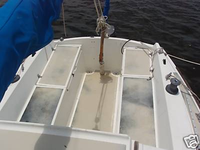

One more difference, but this is a maybe. THe ODay 28 has a modified "T" shaped cockpit to accommodate the wheel. It also has a narrow bench at the back (stern) of the cockpit that is raised (kind of a half moon or hump) to give the helmsman better forward vision. I believe, but am not certain, that the 27's just have straight cockpit benches.

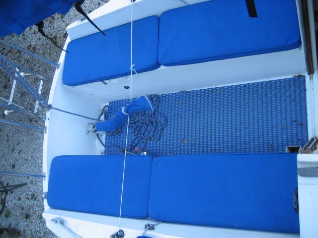

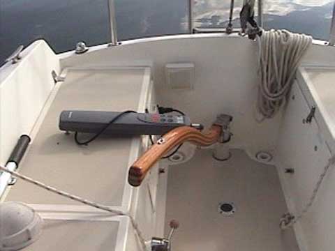

Dennisv; you are correct, the 27 had just the side benches for seating in hte cockpit, no seat across the aft end. See pictures below.
