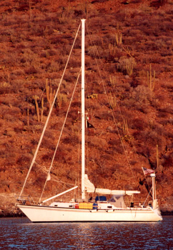

I am a completely unbiased H37C('79) owner. Thus I agree with both Gary and Tom. The H34 is a heck of a boat, just read the "Trans Atlantic" story over on "Big Boats". The decision for me was dollars first, $20K less comparing a good H37C to a fair H34. The larger interior was almost enough to sway us. But as we learned more about Cherubini and his designs, and the construction of the boats, the decision became easier. The keel-stepped mast and cutter rig were important features. The traditional lines means there is less windage and a lower CE(Center of Effort). I can keep full sail with over 20 knots of wind. I think a tender boat like the H34 requires a deep keel where the H37C suffers little from a 4' draft. Tom mentioned a separate shower and vanity. But two couples on an extended cruise will miss that big aft cabin. Just look at those lines in the attached picture(Tom Zyber's s/v Seazure). And that's my completely unbiased personal opinion. :)
