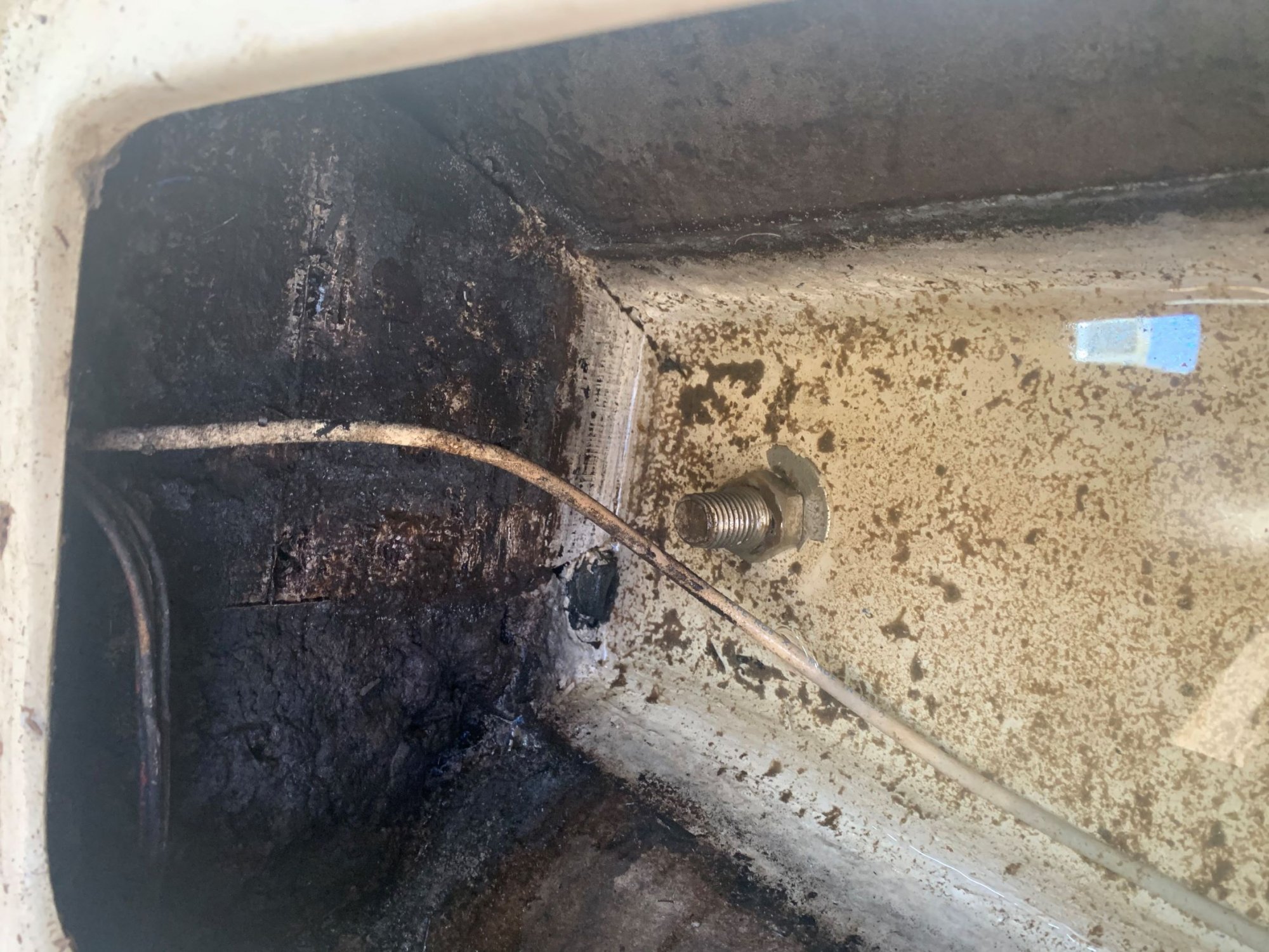

I'm looked at a Catalina 30 today that I'm interested in purchasing but I had a few questions for the group. I have done my research but there are a few things that perplexed me. This boat does not have the T-Cockpit like the mkII's but does have the internal halyards and does not have a wood spreader. I was under the impression that all of those things came together with the mkII. Is it possible this boat got some upgrades but not others? It's a one owner boat that is being sold by a widow so unfortunately most of what I know is in the documentation kept by the husband (who kept alot btw). It's hull number #4543.
I'm also curious about the mast compression post. I inspected it visually and pressed into it. There was about an inch of water in the bilge and the are signs of water in areas around the post. It does seem to be fairly solid though. I've read about this repair job and I fell comfortable taking it on but I'm more curious on if this is going to be a ASAP repair or something that could wait awhile.

I'm not sure about the compression post ( Is that it in the background?), but it looks like the keelbolt washer has broken. The bolt looks good but it needs a new washer or better yet a plate. I have no idea re the reefer.

Yea it’s hard to make out with the glass and paint. The washer is there an intact I think but part of it has paint over it. The part you see just had the paint rubbed off. I’ll take a closer look at that though.
The bilge has water just under the automatic pump threshold but I think it’s running down from the anchor locker which had quite a bit of water in it and appeared to be clogged at the drain.
You cannot tell from this picture but there is a slight radius to the bottom profile of the bilge, (bulges in the middle). A plate would need to be bent to this contour.
The washer is not broken. It is partially covered by paint that was applied to about the 1-1.5" level. (This is the level that the water will naturally reside at with a bilge pump float switch and low suction point of the bilge pump).
Catalina did not add a lower point for the bilge water to gather in, and so it sloshes around the entire length of the keel area. For a partial solution to this problem please see this article: Build Your Own DIY Arid Bilge or Dry Bilge System
For about $50 you can make a system that reduces bilge water to a very small puddle on the C30. We get the rest with a small shop vac. Dry boat = less mold (see OP picture for the black stuff).
I'm also curious about the mast compression post. I inspected it visually and pressed into it. There was about an inch of water in the bilge ...
You should be curious about this. Catalina put a sheet of fiberglass in the area you pressed into. This, among other things, separates the bilge from the step/compression post. This will be hard fiberglass, but behind it is a softwood step. This is what can become soggy. From having become concerned about this myself, I have read up on this around this forum and others. From what I can tell, there are some other indicators to look for when the step deteriorates. Otherwise, you would need to sample the step to find out.
