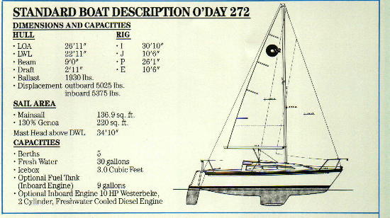

As far as trallering, I suspect the 272 is more "trailer -transportable" than trailerable, remember the beam is 9'0" possibly requiring a wide-load permit (Federal Highway limit is 8'6" to avoid wide load ,local roads may be 8'0" in many stateas.) Weight is also over 5000# for just the boat, add trailer and gear and you need a strong truck to pull. Inboard option (or 272LE will add about 350-400# more)
O'DAY listed cabin headroom as follows: 6'2" under companionway hatch, 6' at forward end of companionway, 5'10" at main bulkhead.
