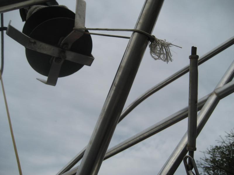

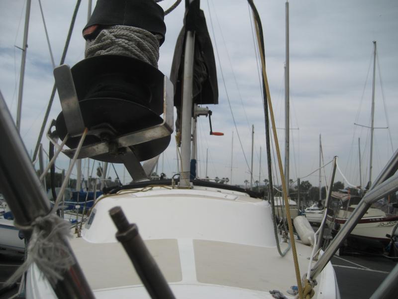

I was power washing the deck of the C 27 yesterday, getting ready to take some friends out for sail. I found that the forestay turnbuckle had broken. I had been out two days before and all was well. It must have snapped after the boat was loaded on to the trailer.
The mast stayed up because the C27 has lowers fore and aft.

WOW I hope you have her tied off better than the photo now!
Run a hallyard to the bow sprit tie that mast off!!!
I would not go up the mast with the other standing rigging in question as in last time total replacement?
Id get mast down,ASP
The lowers relay do not hold the mast from going backwards trust me!!
take a grinder and open the broken turnbuckle up with a grinder at each swage and look for internal rust, lower ones get it worse than upper but failure can happen any were.
Just did our fresh water Catalina 27 and with no idea from PO as when all standing rigging was replace best GRAND I ever spent for peace of mind & safety. ground a few swages( lower) open to find corrosion on the S.S. Swages due to lack of oxygen & moisture.in fresh water now add SALT!
And the embarrassment if you did not kill some one or yourself dragging a dis-masted boat back in!

Tying off with a halyard was the first thing I did. I had Catalina Direct make up th e forestay because I wanted it in a hurry. Turns out I had to mail them the old one so they could measure it. Went up the mast and removed it last week and sent it to them. I will have them then return it so I can dissect it, thanks for the suggestion. Thanks for the rigging supply lead. Their prices are pretty good, although I haven't figured in shipping. We have quite a few riggers in Burbank that supply the studios but they are generally higher than WM.
There is also a rigging supplier a couple of miles from my house who has pretty good cable prices but will have to order in toggles and fitting. When I begin to rig the Luger 30 I will start looking more earnestly.
Have you had trouble with the lowers not holding the mast up during a backstay or forestay failure? I have heard that they do hold even in severe weather if the forestay fails.
