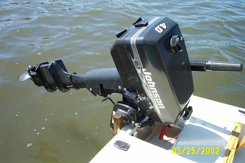

I too have a DS II, a short-shaft will "work" if clamped directly to the transom as O'DAY intended, although you will need to shim it a bit to get a better angle for the mounting. I started out using a short-shaft outboard (2.3 hp JOHNSON) and as I say it will work.....but is not ideal! O'DAY recommends a long-shaft and before buying my DS II I really doubted the need for the long-shaft. I now have a 2001 4HP Johnson with a long-shaft, it was worth the slight extra cost!! I would definitely go with a long-shaft (20") on the DS II especially if I might keep the outboard to use on my next (most likely bigger boat). I no longer have trouble with the prop coming out of hte water in waves, and can move around the boat with out risking the prop coming out of the water. I'l linclude a picture of my boat and motor, I did end up adding a plywood motorboard, bolted to the transom to try to better angle the outboard. I don't like the look of a bracket, especially those adjustable ones that lift the outboard, they look out of place on a low-freeboard boat like the DS II. A fixed bracket is OK, but I prefer what I have.

PS: I added an afterdeck to my DS II, so...that is why in the pictures she may look more like a DS I. Unfortunately, I don't have any pics showing the old short-shaft outboard up close while hauled out.
