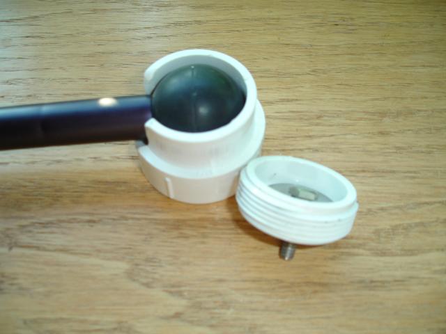

One inexpensive method.. Using the tiller extension the PO put on the boat (extendable and then locks by twisting).
http://forums.macgregor.sailboatowners.com/album.php?albumid=149&pictureid=1437
The cup is just some PVC from Home Depot (hardware store) which just happened to be the right size.

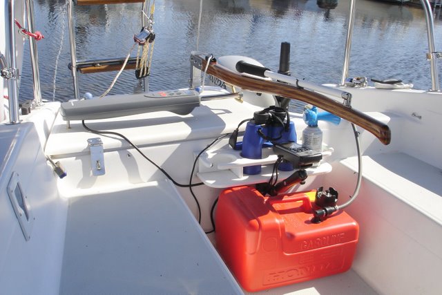

I got a simrad tp10, (on a 1988 26D), Paid about $325 2 yrs ago...
http://www.simrad-yachting.com/en/Products/Leisure/Autosteering/Tillerpilots/TP10-Tillerpilots/
I mounted it in a non standard method, (closer to the pivot point than recommended), it would probably not work on a S since their pivot point is closer to the boat...
used 12v cigarette plug, as a connector... (for versitality moslty), in case I wanted to us a Qbeam at the helm.
here is is
http://i64.photobucket.com/albums/h169/ftldiver2/MACGREGOR/PC160016.jpg
note: it can't steer in over 5' seas, just not fast enough... and it uses some battery power... more power the rougher it gets...
there are settings to change the adjustment rate and power (IIRC). I messed with it when I first got it, and don't mess much with it any more... just set it, and kick back.
http://i64.photobucket.com/albums/h169/ftldiver2/MACGREGOR/P1010014.jpg
since I single handed a lot when I first got the boat, it made life much easier... its still a pleasure to be able to go below and not worry.
-what else do you want to know?

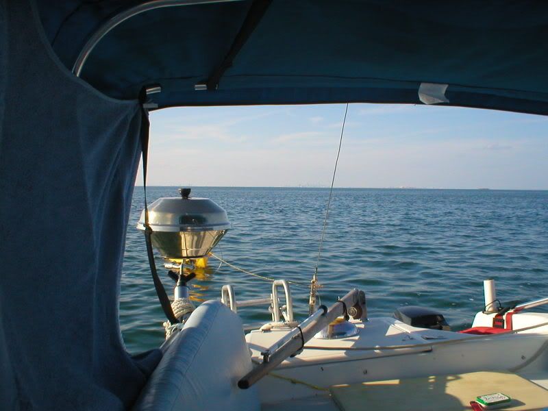

I also have a fixed forspar tiller extension... I do use it sometimes... more before the pilot.
http://i5.photobucket.com/albums/y159/ftldiver/hmstdMarch06/P3310019.jpg
the pilot has a red center button, I typically get a course I like, and press the center 'set' button. and its on... (steers magnetic). if I need to change course I can hit either blue arrow button to adjust course stb or port (rt/left) press once for small (5degree) adjustment. 2x for 10 degrees, etc.
if I need to make major adjustments, I press the 'stop' or set button again, and lift the pilot off the pin... if I foget to turn it off, it will still try to steer the old course and will blow the inline fuse. (no fun),
I see a lot of folks set the pilot on stb side... I wanted port, so I have the motor and pilot controls on one side... (and better access to laz) -(default TP setting is for stb).
-but its not difficult to chg to port if you read the manual.
I also wanted the top of the pilot slightly higher than the tiller, this helps when I lift the laz hatch when on pilot.... I also use a bungy to help hold it on the mount.. (didn't want to loose it overboard...
the TP is plenty strong enough mounted about 4" shorter than recommended... have not had a problem... but I also have the ida modified rudder, so less weather helm...

Edit: note the line running from cleat to cleat and wrapped around the jam cleat,(under the tiller), to keep the rudder centered at anchor... or could be used like tiller tamer... (as I did before the TP was installed).
