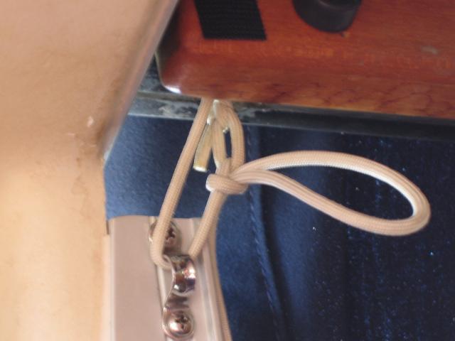

Attached is a picture of the simple hatch locking system that I have used for years.
A strap eye is attached to the companionway channel and another is attached to the wooden bar on the sliding hatch. The acrylic hatch boards are put in and the sliding hatch is closed. An approx 18 inch long, 1/8 inch piece of line, with a bowline on one end, is threaded thru the two strap eyes. One end is put thru the bowline and tied with a slippery hitch. The sliding hatch can not be pushed back so the hatch boards can not come out of the channel. It can be opened instantly from the inside with a pull on the slippery hitch.
The black patch on the wooden bar is a stick-on piece of Velcro, the hook side. There is another patch on the other side of the bar. A privacy curtain of black velour cloth is touched to the Velcro patches and hangs down inside the boat blocking the view into the boat thru the hatch boards.
The blue background cloth should be ignored, it was put up to enhance the photo.
Thanks Stu for your note.
Allan

Even with the picture and the description
I'm sorry, but I still don't understand it.

Looks like..
two eye straps and a piece of line.
I like it, simple, cheap, easy to operate

To orient you, Stu, the picture was taken from inside the boat looking up and aft at the left upper corner of the hatch opening.
The hatch boards are not in place but the horizntal acrylic hatch cover is in the closed position. The wooden bar that is used as a handhold to move the acrylic hatch cover was mounted by Hunter, on the acrylic hatch cover, about 2 inches forward of the aft edge of the acrylic. In the picture, you can see the two inches of acrylic hatch cover aft of the bar.
On a H376, the companionway opening is framed by a vertical U shaped aluminum channel (you can see one of the strap eyes attached to it). The two hatch boards slide down on top of each other in the channel. The horizontal acrylic sliding hatch cover is slid aft to close the companionway; the aft most inch or so of it covers the top edge of the top hatch board. Thus, you can’t get the hatch boards out, to open the companionway, unless you slide the hatch cover forward. If you tie the hatch cover bar to the channel thru the strap eyes, the hatch cover can’t slide forward. Thus, the companionway can not be opened.
Allan
